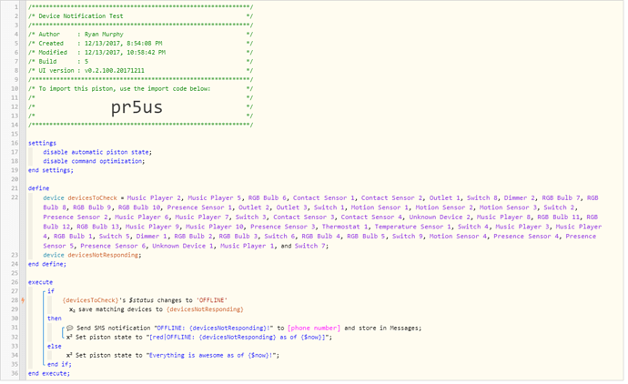

It appears that my piston isn’t properly recognizing the device state.
When a device’s status changes to offline, I’d like to be notified about it so I can take action to fix/repair. I only want to receive a notification once and would prefer to receive notification somewhat quick, without bogging down the system with processing the piston all the time.

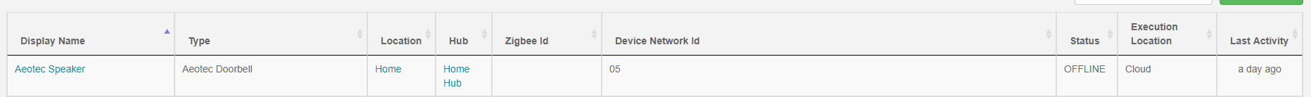

A device within my list has been offline today and I haven’t received any notifications. The piston state shows all devices are normal but my hub shows one device as offline.
I’d also like to avoid defining all the specific devices and am hoping it would just check every available device. This is based off another piston found in a different thread but it seems like I’ve mucked it up a bit. I added the “every” statement in the most recent versions. When I add an SMS notification to the “else”, I was getting texts every time the piston was run so it seems like the problem is with it recognizing the statuses.
Here’s what my IDE shows:
Change your IF statement from “changes to offline” to “is offline”.
Since you’re not subscribed to changes in event status, your piston is only executing every 30 minutes. Unless the device changed to offline within a few seconds of the piston running, “changes to offline” will be evaluated as false.
“Changes to offline” is an instantaneous, real-time condition.
As an alternative, you could get rid of your 30 minute loop and just use the “changes to offline” as a trigger to make your piston run.
After I posted that, I was wondering if the “changes to” would clash with the timer statement I had set up but I don’t have too much experience with CoRE or webCoRe quite yet. Good suggestion!
How would the piston subscribe to changes in event status? If I get rid of the timer statement (which I’d like to do), would this notification work?

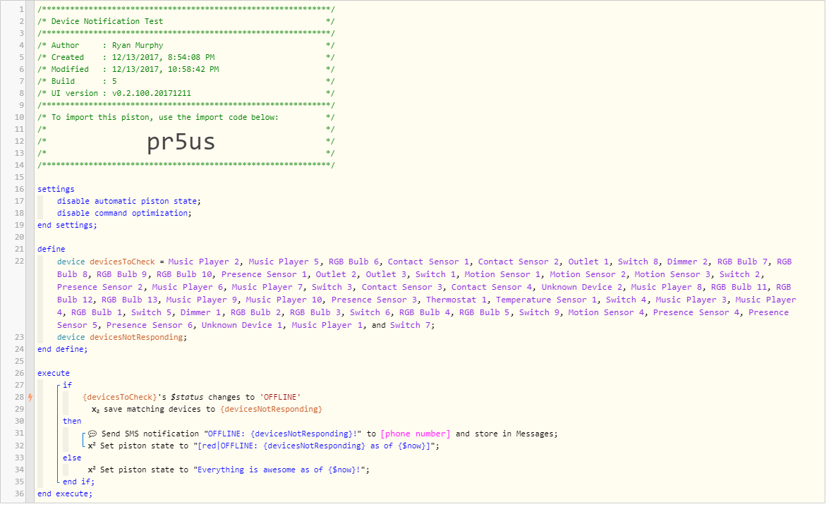

Here’s an update based on your notes:
Do you think this will accomplish my goal? I enabled (confirmed via IDE as ONLINE) then unpublished a device that is somewhat easily testable so we’ll see if it works. Let me know if I should make any other changes.
Thank you!
That should work! That little orange lightning bolt on the left of your piston indicates your piston is subscribed to that line. So any changes associated with the device, devices, or variables in a line with that lightning bolt will trigger your piston to run.
Now your alerts will be real-time rather than waiting for the 30-minute window to run down.
Hmm… I don’t think it worked. I plugged in my Aeotec Speaker to change it from OFFLINE to ONLINE then unplugged it last night. It didn’t switch back to OFFLINE this morning when I checked but it is showing as OFFLINE just now but I didn’t get any notification. Could this be a problem with this particular device? Any recommendations for how to test other devices?

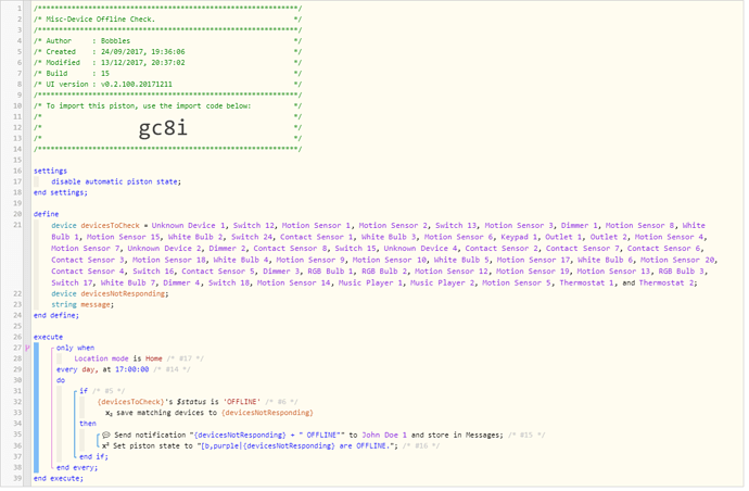

This works for me.
It’s a daily check for devices that are offline.
Very similar to above but not quite.

Thanks for sharing this piston. Yours works because the the timer statement mixed with $status being IS instead of CHANGES TO. It appears that there’s an issue either on the SmartThings side or maybe with webCoRE which doesn’t properly subscribe to $status with CHANGES TO. I’ll send a report to SmartThings about it to see if they can provide more context or perhaps open as a defect to fix.
My goal was to only have one notification when a device goes offline but not every time the piston is scheduled to run (because that would be notification overkill). Perhaps if I could set it up so there’s three variables defined: 1) devicesToCheck, 2) devicesToNotify, 3) devicesNotResponding. I’m trying to figure out if there’s a way I can send the SMS with the devicesToNotify variable value then add/move that value into devicesNotResponding (and have the piston show those values) while clearing devicesToNotify so it can be ready for another device to be added to it if it goes offline. I’m trying to figure out how to do this within the UI.
#16
Maybe just change it to do a check every hour, 2 hours, whatever you want.

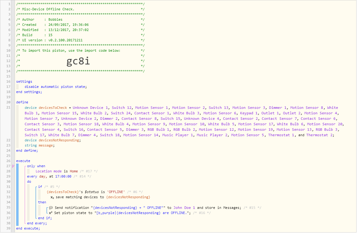

I think I’m getting closer to my three variable idea. The only thing I need help figuring out is how to clear a variable and how to determine whether a variable is null/empty.
#18
So if your devicenotresponding variable has a device and it, and you fix the problem with the device to make it online again, how do you clear the variable?
So that the next day at 1700 you don’t get an incorrect notification that the device is still offline Because the variable did not reset?
