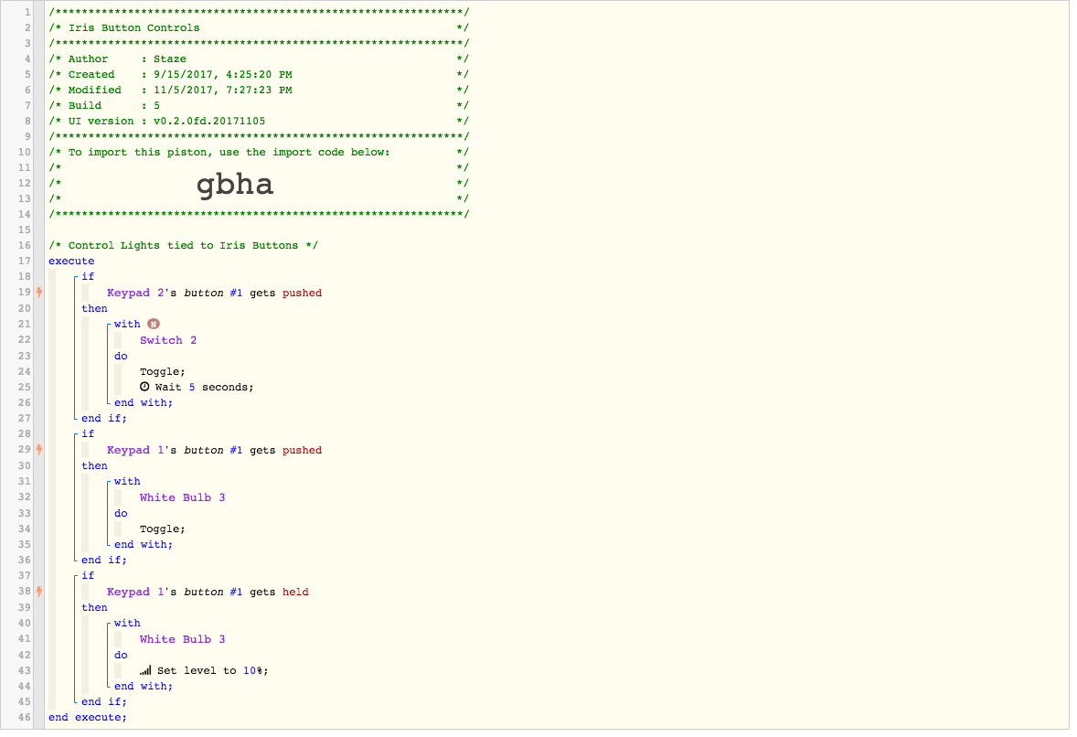

Hi All,
I have the attached piston, and it’s finicky because of the button (Iris Smart Button II). They’re notorious for being annoying. In my case it double taps. So I click it quickly, and the “Switch 2” come on, but then a second or two later go back off.
Anyway, I can’t get the wait to work right, and I’m guessing it’s the “with” interruption. I’ve set to never, but that doesn’t seem to work.
What am I doing wrong to keep this errant second tap from turning things back off?
Thanks!

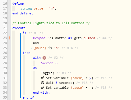

Give something like this a try… basically a cool down period (you can adjust) where the piston will not respond to another button press until the variable resets.

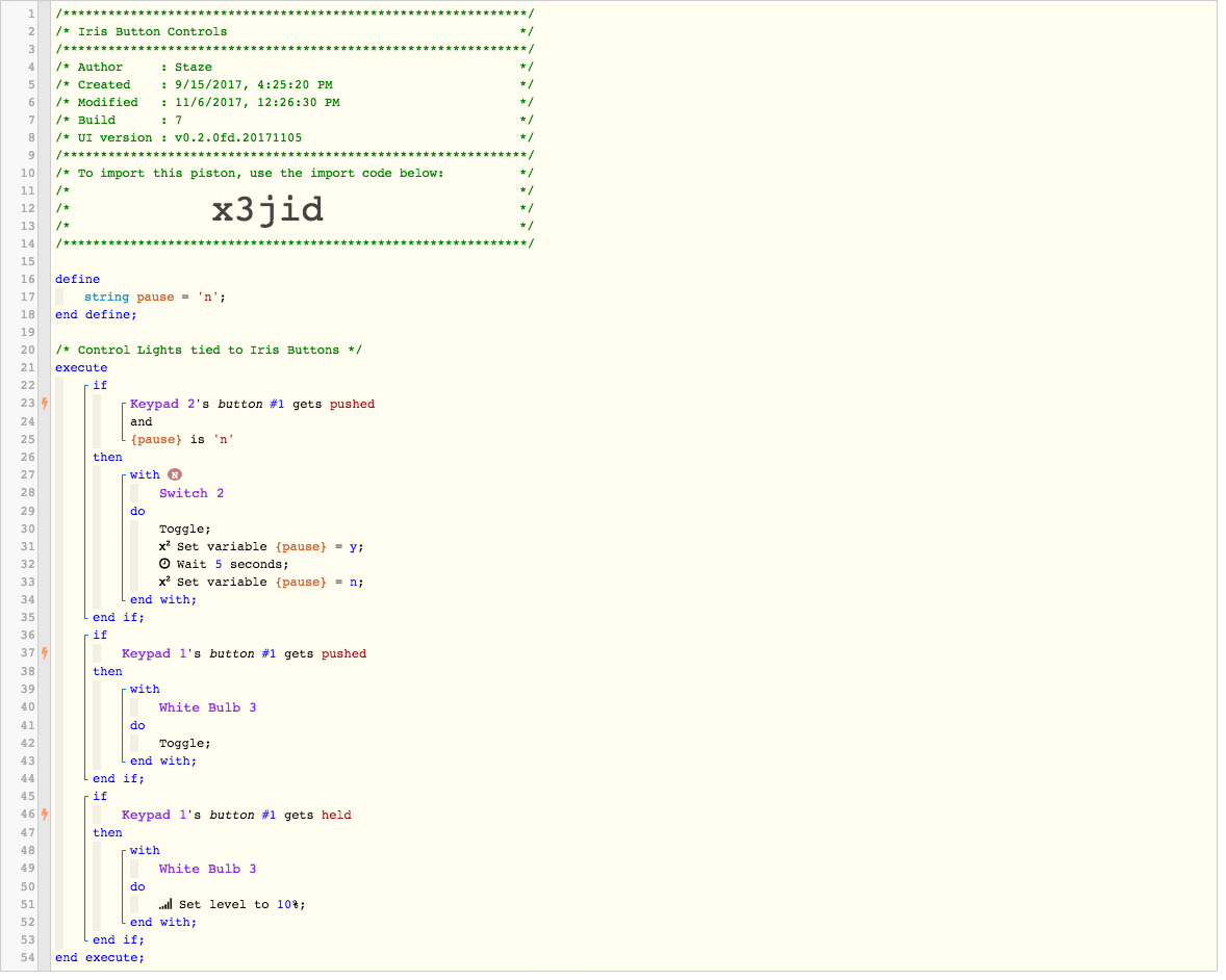

hmm, adding the pause doesn’t seem to work.
And I thought the "with (n) piece was changing the task cancellation policy. The button itself (keypad 2) already has it set to never.
Here’s updated piston. =/
The logs for the piston sure seem to indicate it isn’t actually waiting…
