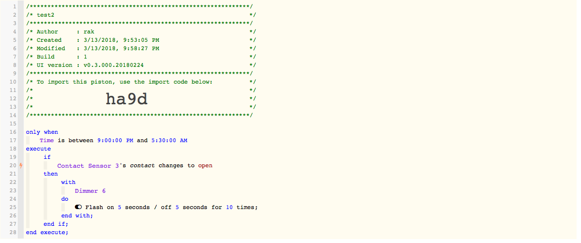

Hey Guys…hoping someone can help out here…Some how my garage opened up via my relay the other night, and I got a knock on our door at 12:05AM from the police that my garage was open (thankfully!) My sensor battery was out, otherwise it would have alerted me via a push notification.
I have a dome siren that I’d like to setup for the following
If between 9:00PM and 5:30AM and the garage opens,
Flash the dome and use one of the sounds.
I’m having trouble getting started using the between times. Any help would be appreciated!
