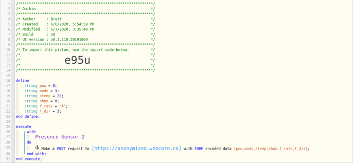

I’m attempting to get an HTTP POST request working to control an air conditioner with a fairly basic rest API. The request is not being sent to the API as expected, however the logs do not show the raw HTTP request so I am having trouble determining the issue. I have a simple test request set up using postman and am successful with control. Where can I find documentation on using the HTTP request feature of webcore?

I think I could get it working if someone pointed me to the HTTP request feature documentation of webcore; I’m sure it’s something simple I’m missing.
Not aware of any documentation but I would start with logging the $httpstatuscode. Do you get a response in postman? You might be able to log that response also, $response.
I found the issue. I thought that clicking the execute piston external URL would execute the HTTP request, but I guess I misunderstood that link. To run the script the “test” button needs to be pressed.

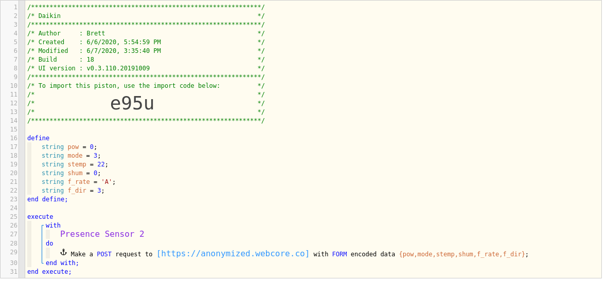

In my experience, clicking the
pic
will execute the piston, similar to pressing Test.
I run scripts by using that URL quite often.
