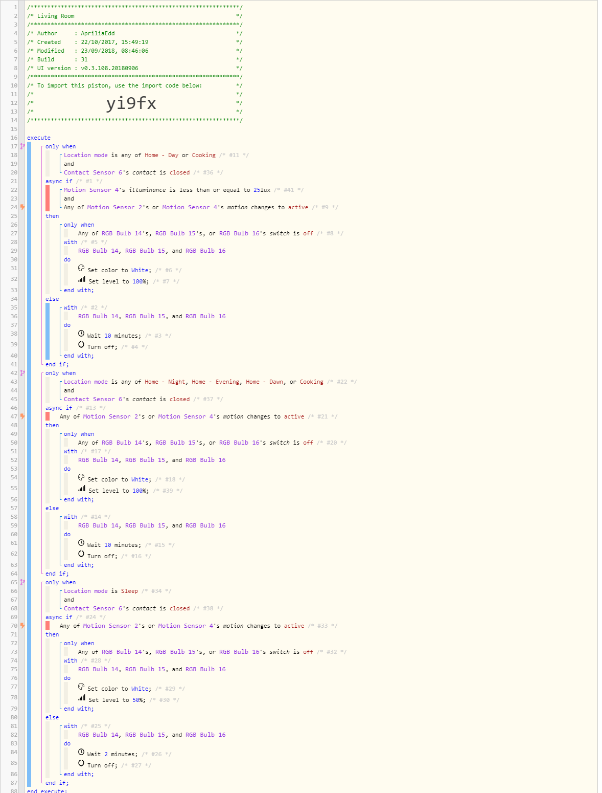

Help with lighting piston
lights not going out when lux level rises above 25
between sunrise and sunset if i enter the room and the motion detector triggers the lights. once i open the blinds and the lux level increases then after 10 minutes the lights should go off. i would have expected it to need the motion AND lux <= 25 to reset the timer
the wait counter keeps resetting to 10 minutes every time the motion detector is triggered thus never turning the lights off once its light.

Thanks for any help with this everything else in this piston does exactly what i want but i can’t solve this niggly bit.
A timer nested inside a trigger for a motion sensor in an asynch IF statement with restrictions has just about every possible headache you could give yourself while trying to write a piston. :slight_smile:
The timer resets every time your IF condition evaluates false, meaning when your motion sensor changes to inactive the timer will reset regardless of lux value.
The easiest workaround I can think of off the top of my head would be to create a separate IF condition to turn your lights off that doesn’t include the motion sensor. A simple Boolean variable can be used to make sure the lights are on from automation and will prevent the lights from being switched off at other times that the room is well lit.
Define Variable
Boolean lightsAutoOn
After your actions to set color to white and level to 100% (line 32 as pictured in your green snapshot)
Set Variable lightsAutoOn = true
IF
lightsAutoOn = true
AND
Lux > 25
Wait 10 minutes
Turn lights off
Set variable lightsAutoOn = false
Thanks, i might try that but i’m also experimenting with Rooms manager to see how that goes. seems to work well in my office so far.
