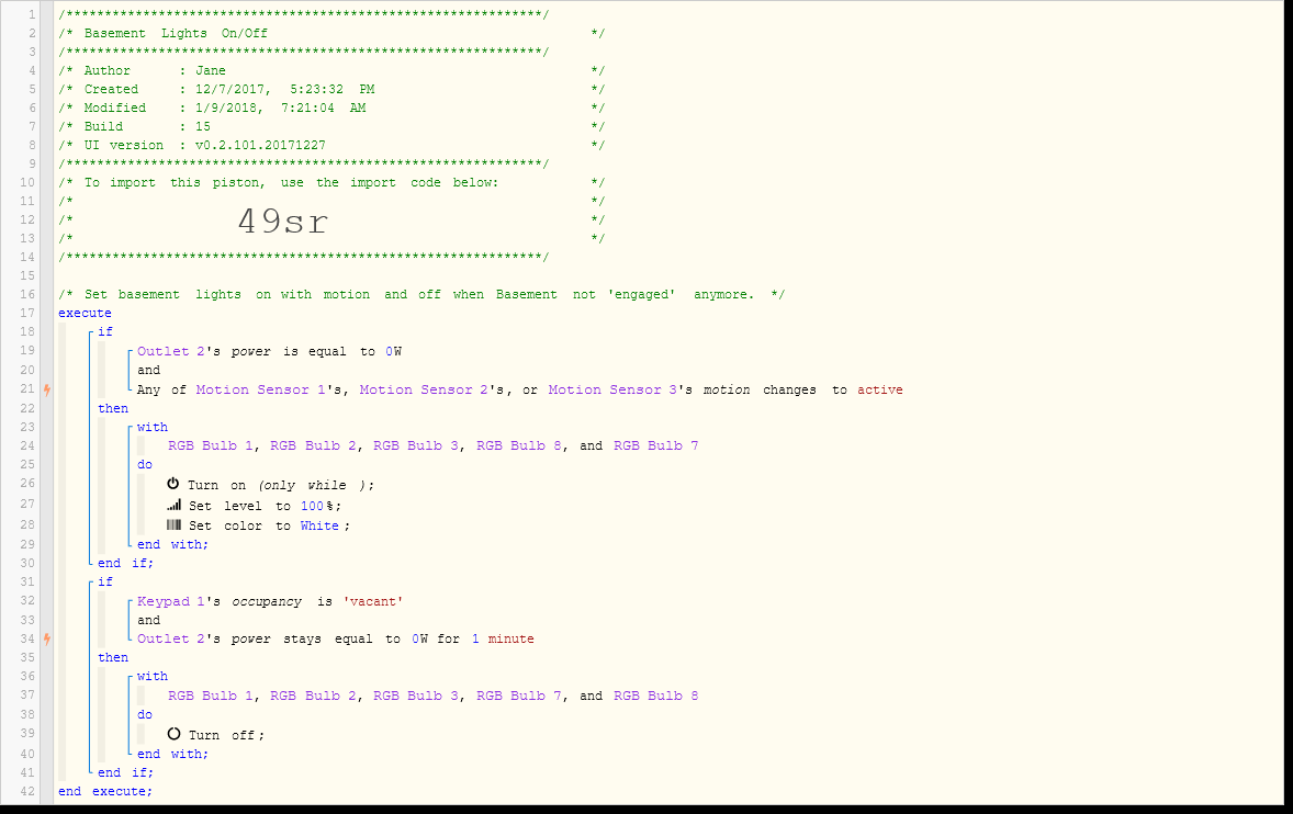

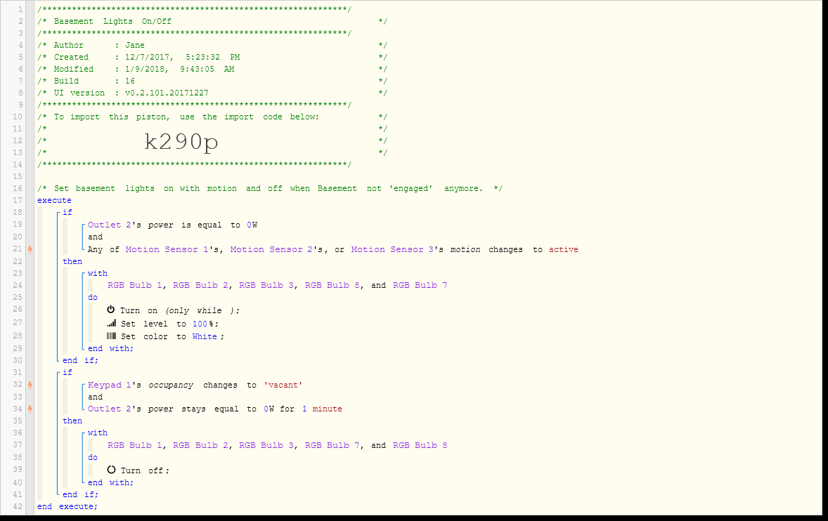

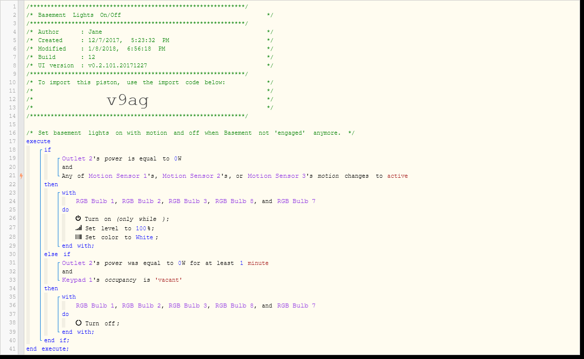

The lights aren’t turning off after the room turns to vacant and the TV has been off for at least a minute
When the room is vacant and nobody is using the TV, the lights should go off.
Lights aren’t turning off.
