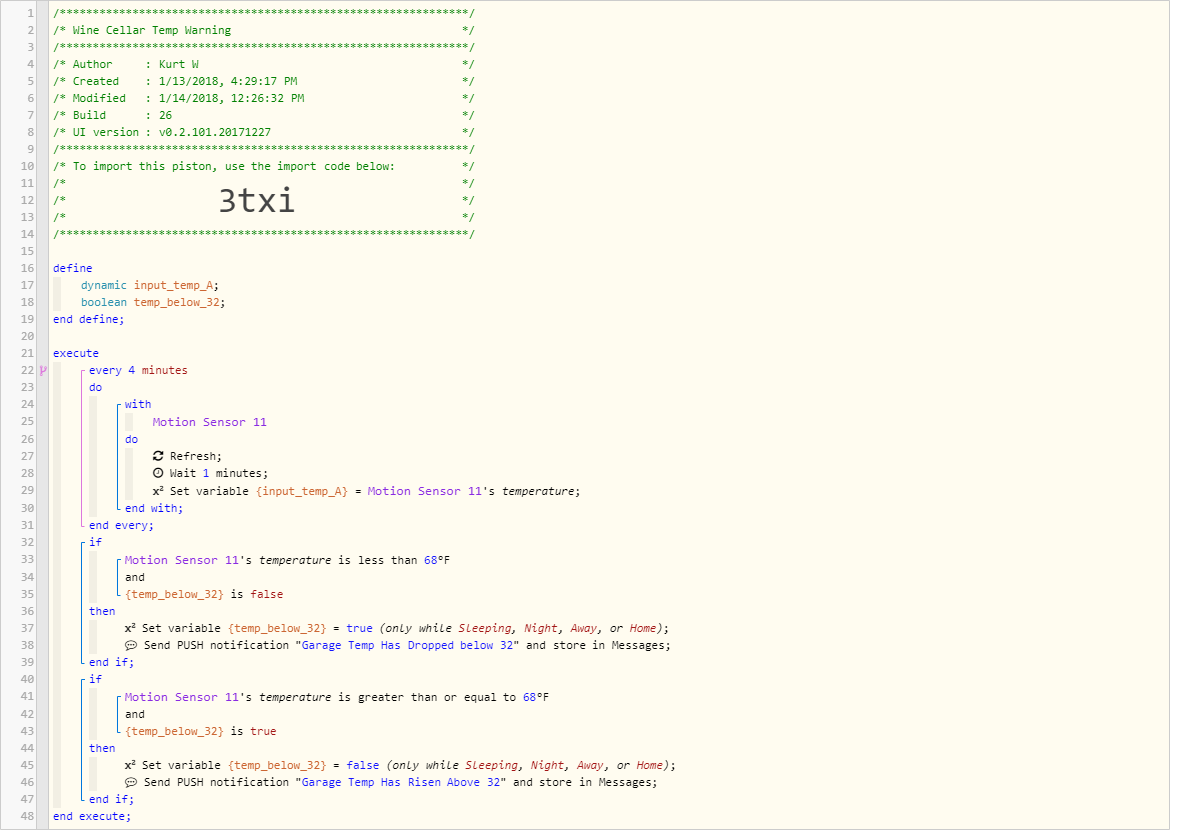

I cannot get this piston to send the notifications. Can anybody see why? When I use the “Test” button in piston design, I do get notifications. The variables do seem to be getting set correctly.
I have the time set to run every 4 minutes just for testing purposes. Normally I will set it to once an hour.
I want the notification when the temp in my connected garage drops below 32, so I can pull any freezable liquids indoors (water, soda, beer, tc). I don’t want a notification every hour. Only when the temp drops from above 32 to below 32. If it staying below 32, no notification is needed. And visa versa, changes to above 32. Does that make sense?
Any help would be appreciated.

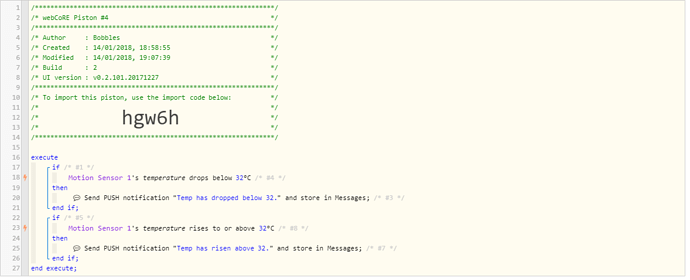

Would something simple like this work for you?
Thanks Bobbles! That works. I guess I was over complicating things.
No problem.
