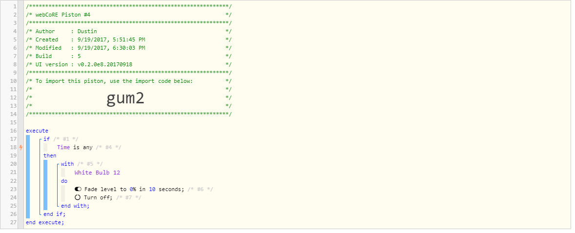

Help with motion/lights piston

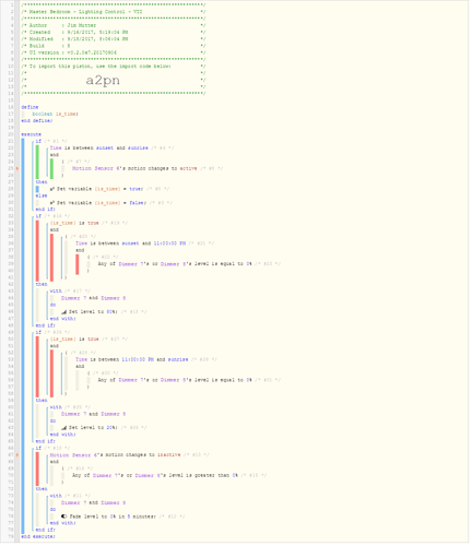

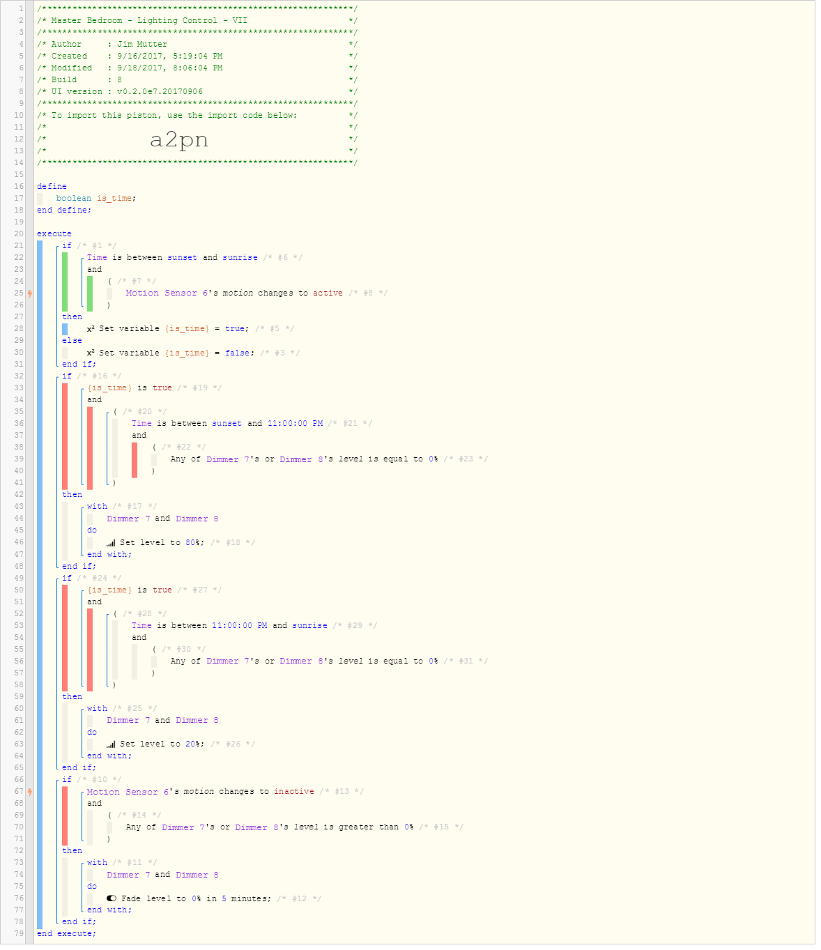

This piston is giving me a few problems and I’m hoping y’all can help me figure it out.
(A) - The piston doesn’t reliably fire. For example, I just went in to the room and nothing happened. Not sure why - this seems pretty straight forward.
(B) - The piston fires with the lights @ 20% and never @ 80%.
© - The piston fires @ 20% outside of SUNSET to SUNRISE. Why?
The piston should work as follows:
  • if [ time is between sunset and sunrise ] AND [ motion detector changes to active ] ; then set ‘is_time = 1’
  • if [ ‘is_time = 1’ ] AND [ time is between sunset and 11:00PM ] AND [ lights are off ] ; then turn the lights on to 80%.
  • if [ ‘is_time = 1’ AND [ time is between 11:00PM and sunrise ] AND [ lights are off ] ; then turn lights on to 20%
  • if [ motion detector changes to inactive ] ; wait 5 minutes, fade out lights.
Thanks, everyone, for the help. I appreciate it.
Lots of logs below.

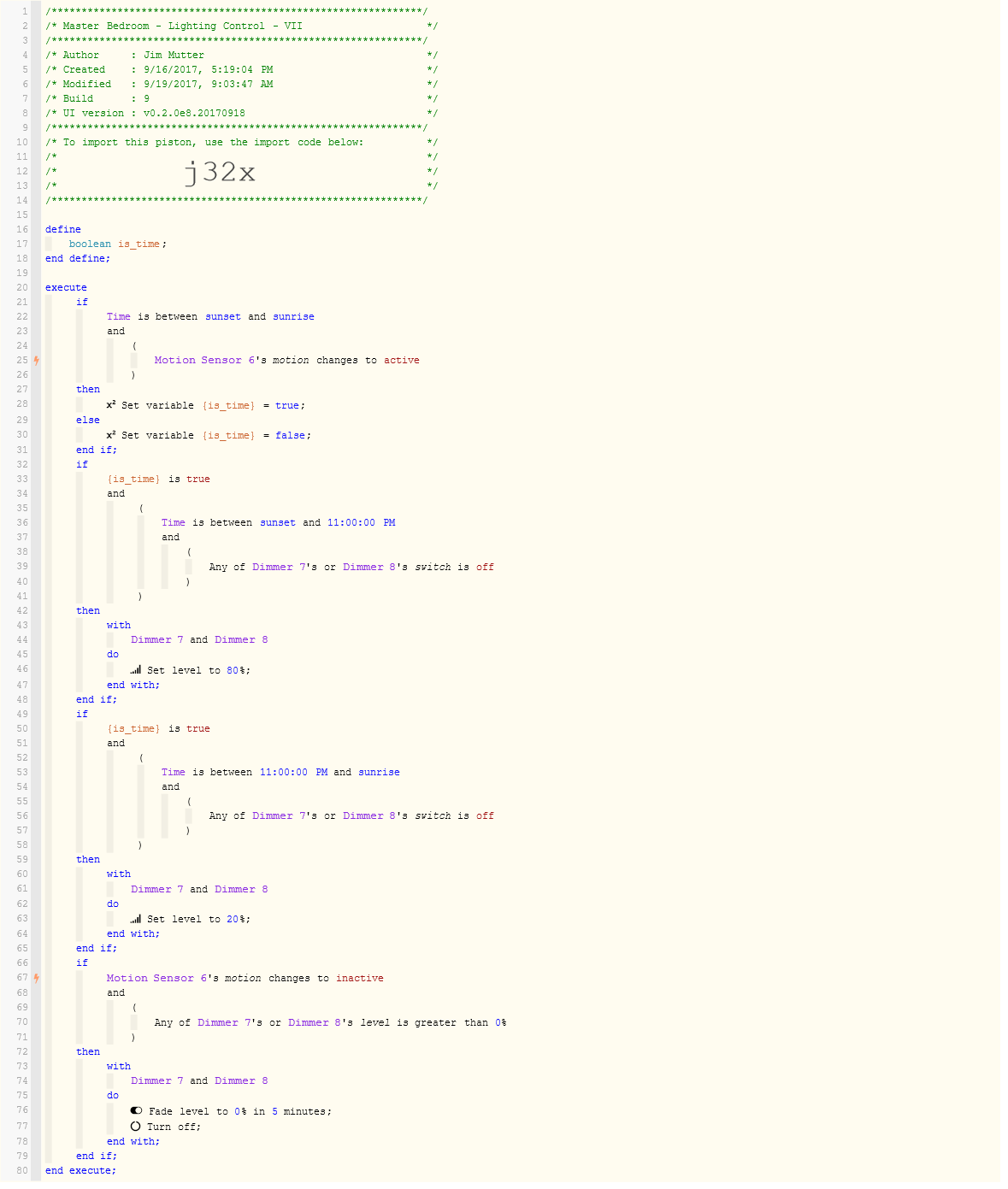

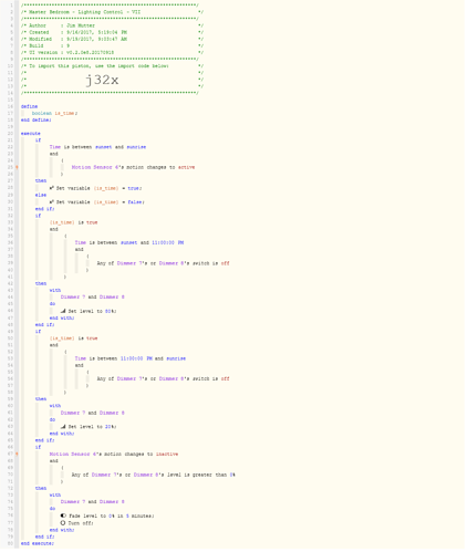

Instead of checking the dimmers to be at 0% try checking if the switch is off instead
Edit: one thing to note is that anytime you’re motion goes inactive and your lights are on they will fade to off in 5 minutes no matter what time of day
Thanks for the heads up on the “switch” as opposed to guessing based on level. I’ve made the change and I’ll find out tonight how that works.
I have the other issue of the piston firing at weird times (like during the day) - I just found that the webCoRE console seems to think it’s night time. Did I do something that caused that? If so, where do I undo it?

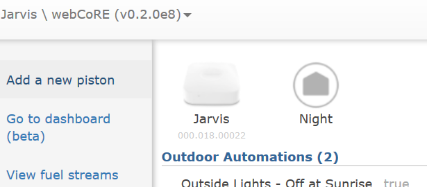

Night Mode
Not quite sure I know what you mean. But make sure your location is properly set in the ST IDE. You should be able to move you pin around in the ST app settings on your phone. Save it. Move it back and save.
I checked and double checked. Location is fine - and I’m pretty sure “Night” mode wouldn’t necessarily affect time based automations.
What’s causing the lights to come on @ 20% during the day? I’ve been over the code more than a few times - but I’m open to the idea that I’m missing it because I’m seeing what I expect to see, not what’s actually there.
Do you have any logs. Also can you post up the current photo of the piston you are using.
The night is your current location mode. Not necessarily the time
See below. Thanks so much for the help. It is really appreciated. Also - the lights just came on - and while it was CLOSE to sunset, it hadn’t yet arrived.
Edit: Good news is that the lights came up to the programmed 80% immediately after sunset.
Piston:
Logs:

Make sure the trace toggle is on. It will help visually identify the flow of your piston.
Also all those logs are showing that Time between sunset was false. So any lights that came on were a result of your If statement on line 68. As noted above having trace enabled will help you visually see what is going on in the piston during evaluation. Blue bar means some event caused evaluation. Green means it evaluated true. Red means it evaluated false. And if the bar remains grey then it did not evaluate that at all.
Trace is now enabled. I must have turned it off inadvertently.
re: the “if” statement @ 68 - that turns lights off, not on. Or am I missing something?
Regardless, I’ll sit tight and wait for tomorrow morning - this time with Trace on.
Thanks again for the help. Really do appreciate it.

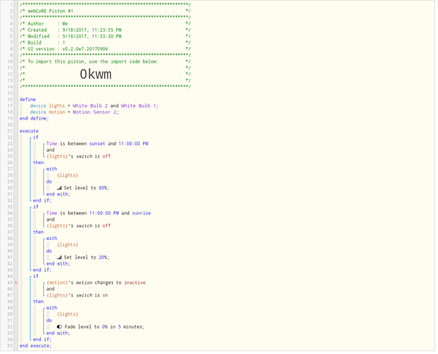

Even when lights are off they still are still set a the level of whatever they turned off as. This is why I steered you away from checking the level and more towards the switch state.
So to test this. I created this piston. If time is any then fade my office lights to 0% over 10 seconds. I like to use time is any because I can just hit the test button and let it run! Anyway, the office lights were off. Pressed test and they came on then started to fade. Even after the action completed the first time pressing it again brought my lights up and then proceeded to fade.
So without some type of condition attached to that if statement on line 68 it will always turn your lights on and then fade them over the next 5 minutes.
Also this piston from post 2 was a revamped version of yours. Cleaned it up and ditched the variable.
