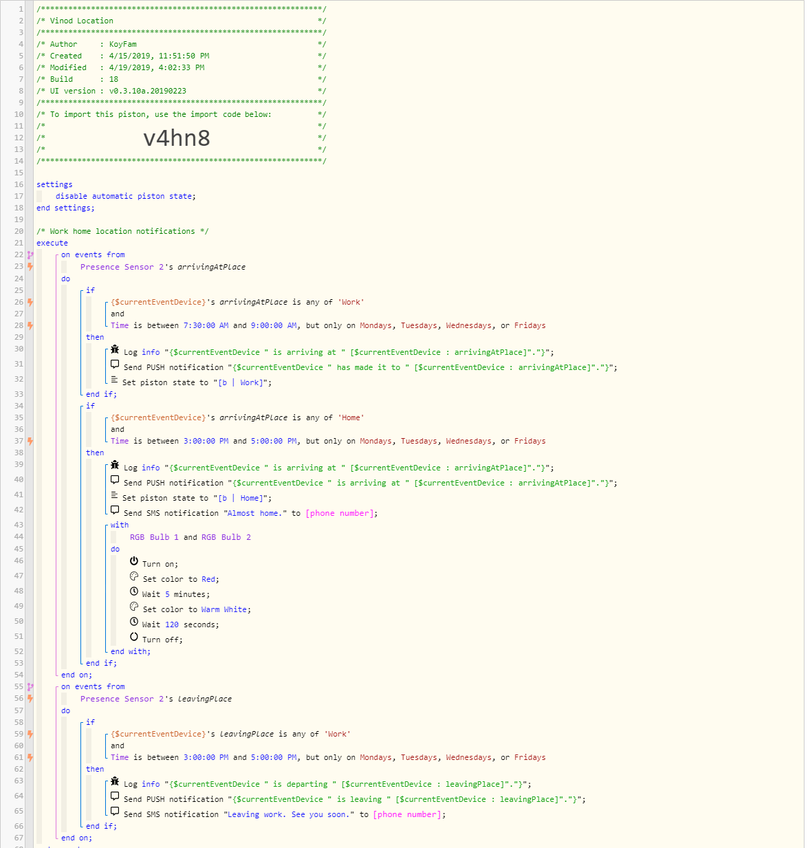

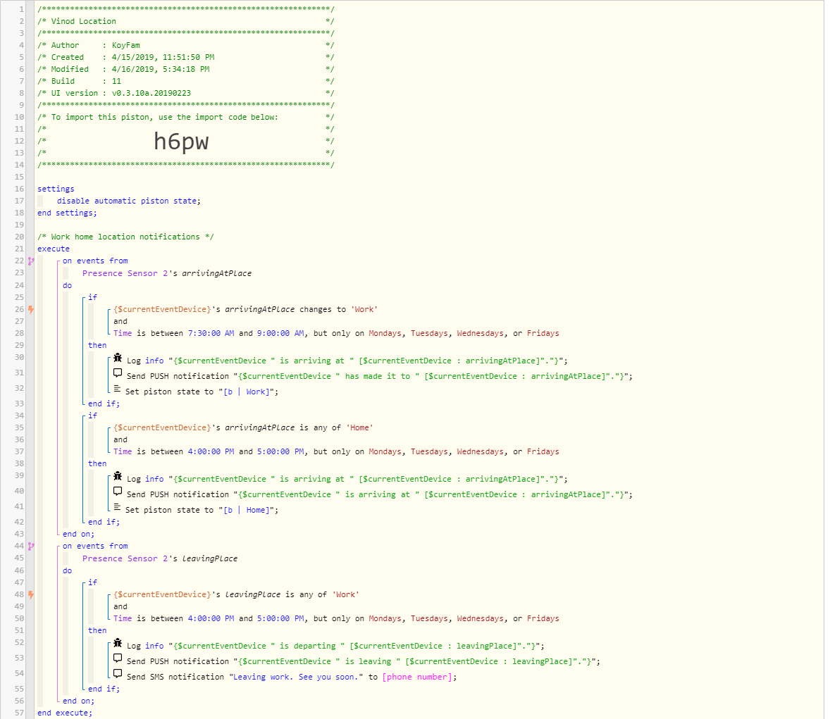

I am new to WebCore (coming over from Stringify) and need some help with this location piston. If someone can review and let me know if it looks efficient. I used many examples that I can find and tried to tweak to my needs.
I want a message when I get to work (only so I know my location updated). I also want to message my wife when I leave work and then another message when I enter “home” location.
Sporadic results. I get a double message when I get to work. My wife gets the 1st message when I leave work but not the follow up message
I just turned on logging so no logs yet. I will have some tomorrow

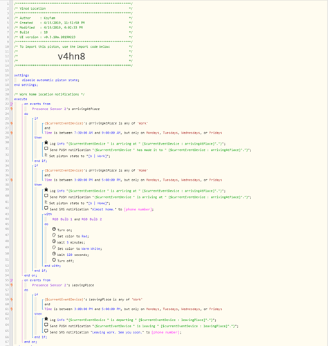

Hello everyone, I finally got the piston to fire properly but still having another issue. When I arrive home, I want my light to turn red, wait 5 mins then change back to warm white, wait 2 mins and then turn off. After it turned on and changed to red, it did not complete the other commands.
Any help is appreciated.
The With on line 43 needs TCP set to Never
Thank you! I added it and will test it out on Monday. I really appreciate the help.

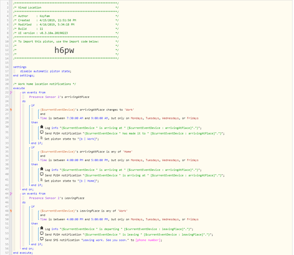

I see this flow uses 56% memory. Is that bad? I am not sure if this can be made more efficient.
I usually ignore the memory number. It has no bearing on efficiency.
