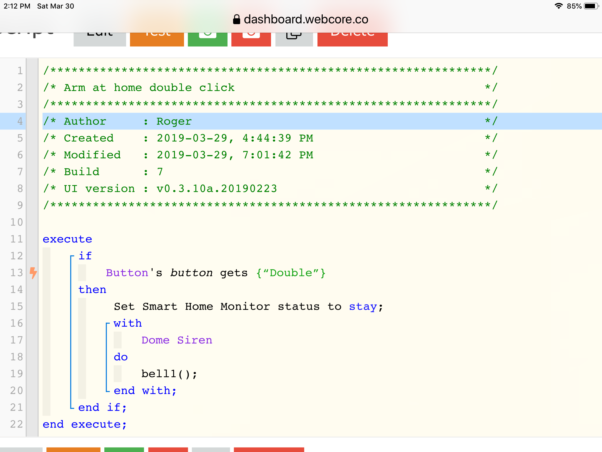

Using help I’ve found on here I’ve developed 3 similar pistons. 2 work perfectly but one only works partially. I’ve carefully compared them but can’t see any issue
This one for example works perfectly
But in this one the system will arm but the siren will not beep
Can someone please advise
Thanks in advance

Is “be111” a typo?
I thought that too, but it’s actually bell1. Just a weird font that makes the lowercase l’s look like 1’s.
I don’t have a button to test with but the code looks right.
Yes bell 1
The only thing really different from the other two is the double press, was created as an expression
It’s executing the first part of the THEN? It’s actually setting the mode properly?
Well, this plus you changed
Beep;
to
bell1();
The issue could be the double press expression, OR it could be the bell1().
To narrow down the issue, you can change the bell1() back to Beep for testing.
  • If that works, then you know for sure it’s the “bell1()” that needs adjusting
  • If that fails, then you know that the double part in the expression needs adjusting
