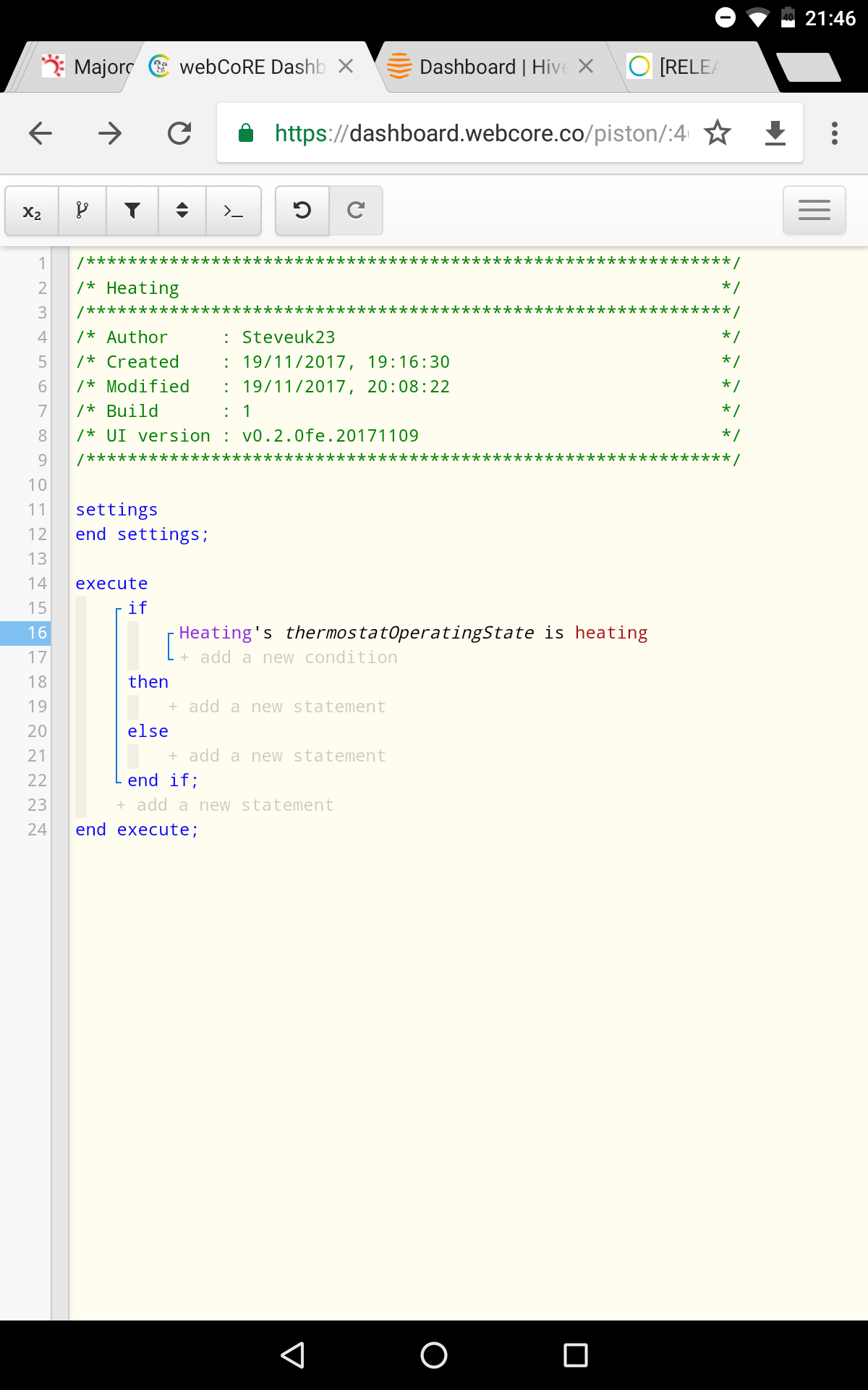

I’m after some help with a piston.
Ours only a simple heating one , basically my kids have been putting the heating onto manual and it’s been left on all night.
So I want a piston for if the heatings been on for longer than 1 hour after 11pm then switch it to the scheduled treating.
But I’m struggling at the very first part :frowning:
I’ve at the first bit “if the thermostats heating” but can’t figure out how to add for 1 hour
Any help cheers

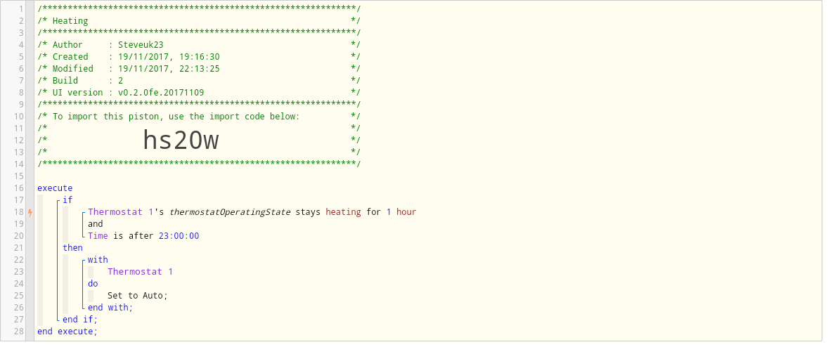

How about
IF
Thermostat is Heating
AND
Time is between 11PM and xxxx
THEN
WITH
Heating Thermostat
DO
Set Heating point to xx C/F. Or maybe set heating to Off. (Up to you).
Is this the sort of thing you are after?
Thanks for that.
I just figured it out the same time you replied
I needed to set it to , if thermostat “stays” heating
Cheers
The only thing that I’m unsure of is the ‘Time Is After 23:00’ part.
I’m not sure if this means it will only work between 23:00 and 23:59.
I really don’t know.
If your heating is off through the night it might be worth putting a ‘Time Is Between’, say, 23:00 and 06:00 maybe.
Just my thoughts on it.
Yeah good point didn’t think about it that way cheers
I’ve changed that now to your suggested times.
But just thought about something.
Say if the heating did get left on and but at 23.50pm it reached the desired level it would switch to idle which would then reset my piston then wouldn’t it as it either be classed as heating.
