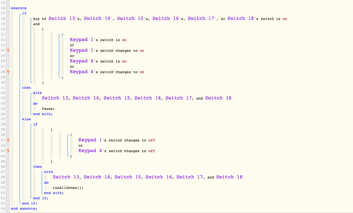

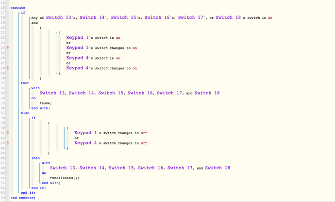

Need help with piston to help pause and resume sprinklers if they are running based on if certain bathroom light switches are turned on or off.
Switch 13-18 are the 5 zones plus the master controller for the Rachio. Keypad 1 & 4 are the bathroom lights. If any of the sprinkler zones are running and ANY of the light switches are on or change to on then the sprinklers should pause watering. Once ALL of the light switches are off or change to off then the sprinklers should resume.
My code is just poor

OK, this project can/will get somewhat complex from the beginning, so let’s walk through this together. This could be a rather large piston, or you can break it up into smaller pistons. I like smaller pistons because it is much easier for me to debug. But, you may want it all in one big piston. So let’s start simple. Certainly there are MANY ways to do this and others here may have good insight. I have sketched out 3 small pistons that have not been tested. I am using a variable, Pause_Rachio, that can either be local or global based on your choice of piston arrangement. You will need triggers and conditions in the correct place and sequence to achieve your goal. I would get one piston at a time working properly, then move on to the next.
Piston 1 - If any of the bathroom lights turn ON and the Rachio is ON, pause the Rachio
IF
  Any of Keypad 1, Keypad 4 Switch changes to ON
  and
  Any of 13,14,15,16,17,18 is ON
  THEN
    With 13,14,15,16,17,18
      Do
        Pause
        Set Pause_Rachio = true
END IF
Piston 2 - If the Rachio turns ON and any of the bathroom lights are ON, pause the Rachio
IF
  ANY of 13,14,15,16,17,18 changes to ON
  AND
  ANY of Keypad 1, Keypad 4 is ON
  THEN
    WITH 13,14,15,16,17,18
      DO
        Pause
END IF
Piston 3 - If both lights turn OFF and the Rachio has been paused, turn the Rachio back ON
IF
  Keypad 1 changes to OFF
  AND
  Keypad 4 is OFF
  OR
  Keypad 4 changes to OFF
  AND
  Keypad 1 is OFF
  THEN
    IF Pause_Rachio is true    (If the Rachio was not running, don't turn it on)
      THEN
        runAllZones
        Set Pause_Rachio to false
    END IF
END IF
