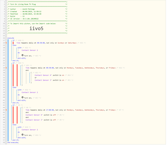

I have a piston to turn on my TV, that is supposed to work like this:
- Weekends -> Turn On at 8:30
- Workdays -> Turn On at 17:30
- On Workays that are holidays or I’m in Vacation -> Turn On at 08:30
Problem: Not working on Holidays (like today that is a Portuguese Holiday)

It seems that it failed on Time verification, on the 2nd IF (condition #12), that was checking for Time = 08:30, and for some reason Failed.
Can anyone help me?
