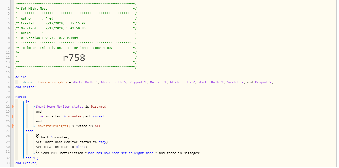

I’ve written a piston to automatically set Smartthings to Armed (Stay) mode once we’ve gone up to bed for the night. It is based on all the downstairs lights being off after sunset. Although it works, if I turn the last downstairs light off but then turn another on the 5 minute offset doesn’t get reset. That means if I spend more than 5 minutes doing something the Armed (Stay) mode will be set regardless.
If I turn the last downstairs light off but then turn another one on, I want the 5 minute offset to reset.
As mentioned above the piston pretty much works except for the timer reset issue I described.
Would appreciate any help to tweak this piston!
