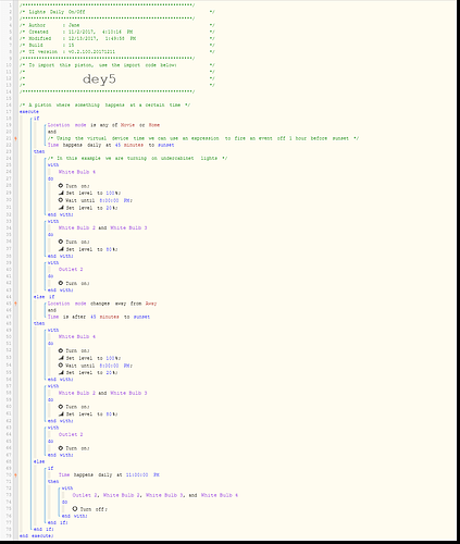

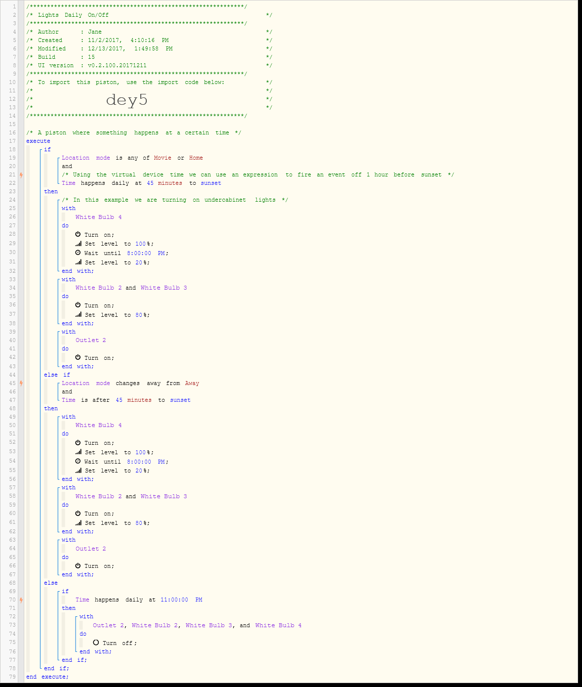

The ‘wait till 8pm’ in your first ‘with’ block is holding everything else up… webCoRE defaults to synchronous so the next ‘with’ block won’t fire until the first block completes.
Click on the first ‘with’, click the cog symbol and change it to asynchronous so the following parts don’t need to wait in line.
Do the same for any other blocks containing long waits.
You could also simplify things a little by using an ‘or’ instead of ‘else if’… saves duplicating your 3 ‘with’ blocks twice.

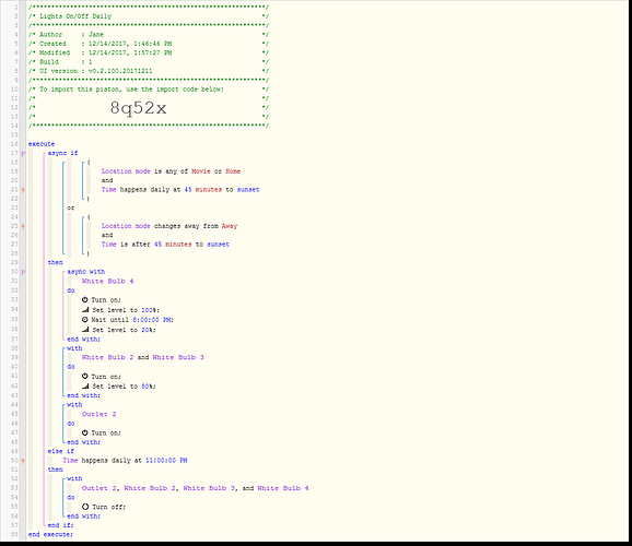

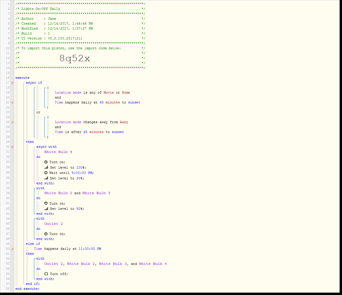

How does this look? Not sure if I need the async around the first while or around the whole IF? I think it just needs to go at the top with the IF.
Looks good.
Should I take out the async setting after the THEN as I have it at the top which would incorporate everything below it?
The async applies to each block, having one at the top has no effect on other blocks further down… it won’t make a difference but if you want to remove an async, remove the top one.

See piston at the top. That is what I was doing originally but the piston was getting stuck on the “Wait for 8:00 pm” in the first While block. So async works there. However, it was also suggested to slimline the piston so as not to have duplicate areas. So I rewrote it. It was a good learning experience!:wink: But what I am trying to understand is where to use the async. If it is at the top with the IF then wouldn’t it incorporate all the blocks within this IF statement?
#17
The Async incorporates the outside block it is in, but not further blocks within that block (I know, confusing).
