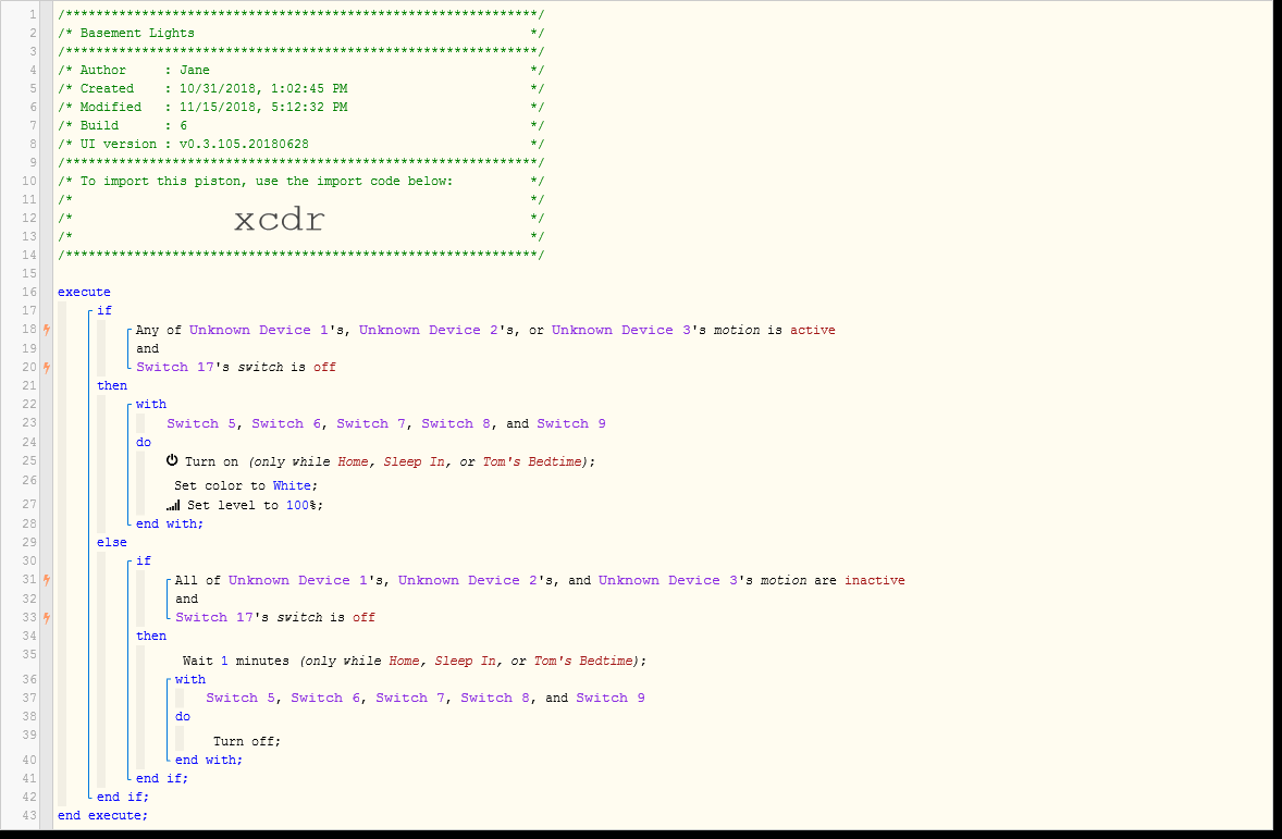

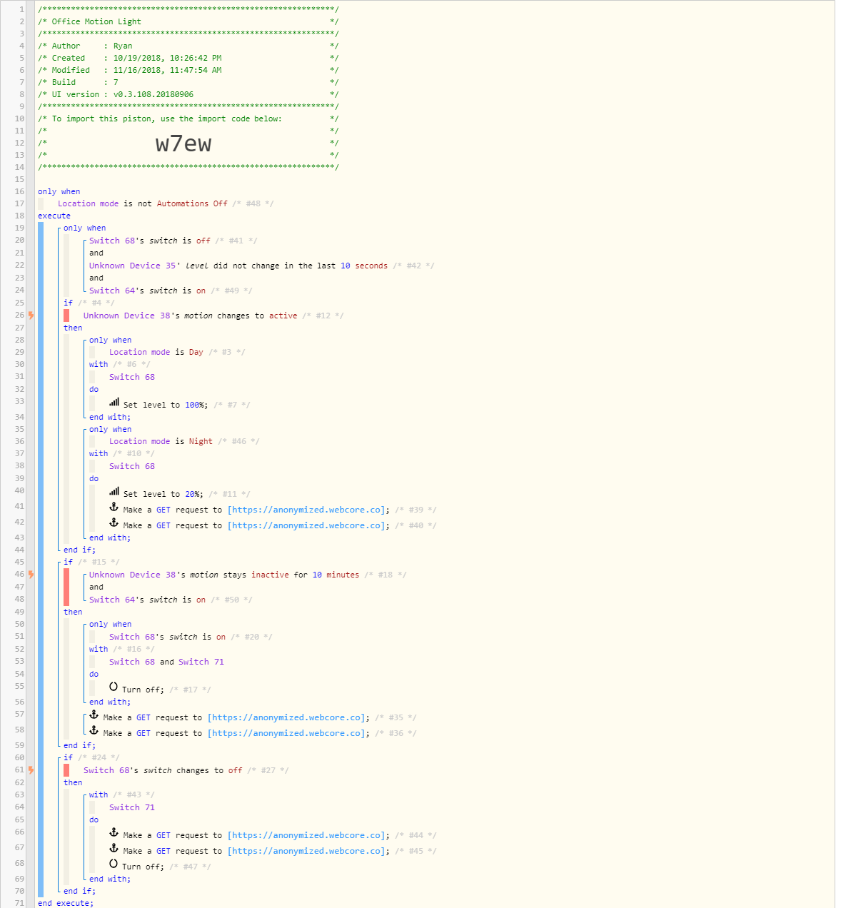

This is the piston that I have setup and I am wondering if I have this right. I have setup a Virtual Switch that I have setup another piston to turn on when the TV plug’s power is higher than 10 and turns off when the power is below 9. So when the TV is on the switch should go on and when we turn the TV off the switch should go off. Then I put it into my Lights piston so that if the switch is off the lights should work as normal. So my question is, if the switch is on and the piston does not continue, will the lights just stay on then? And if we change the light colours it should just stay that way until the TV power goes off, right?
it’s a virtual switch. you can turn it on and off in the ST app or actiontiles…whatever you use to turn things on and off.
