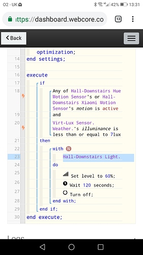

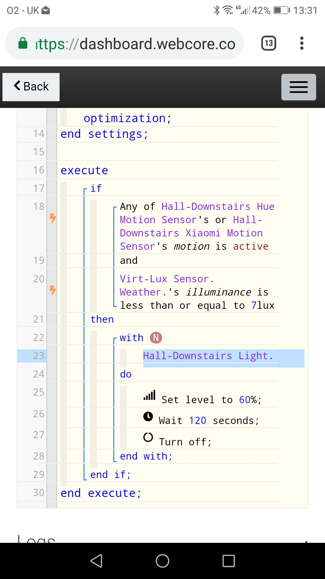

(Trying to set up a piston that uses luminance sensor from one room and motion from another room to turn on lights during the day)
(Lights turn on but they are not turning off )

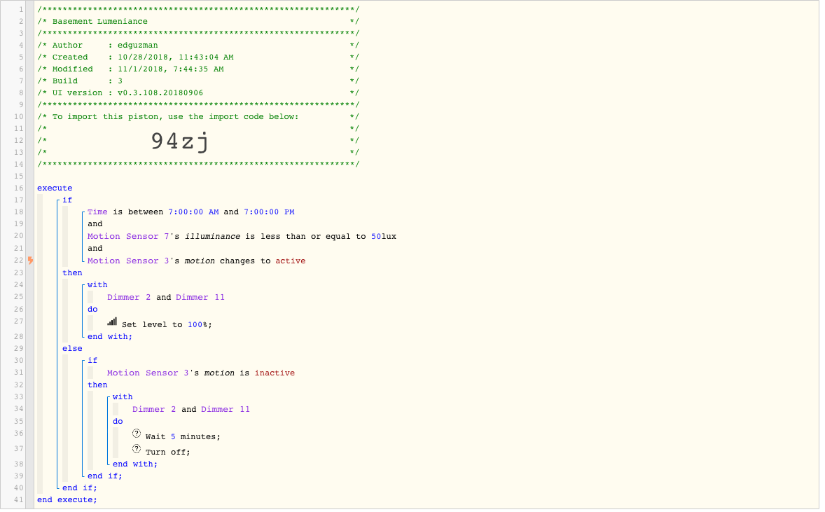

(Iights are turning on fine but for some reason they are not turning off. Also would like to know why is there a (?) next to the ELSE -> DO , part of the piston
