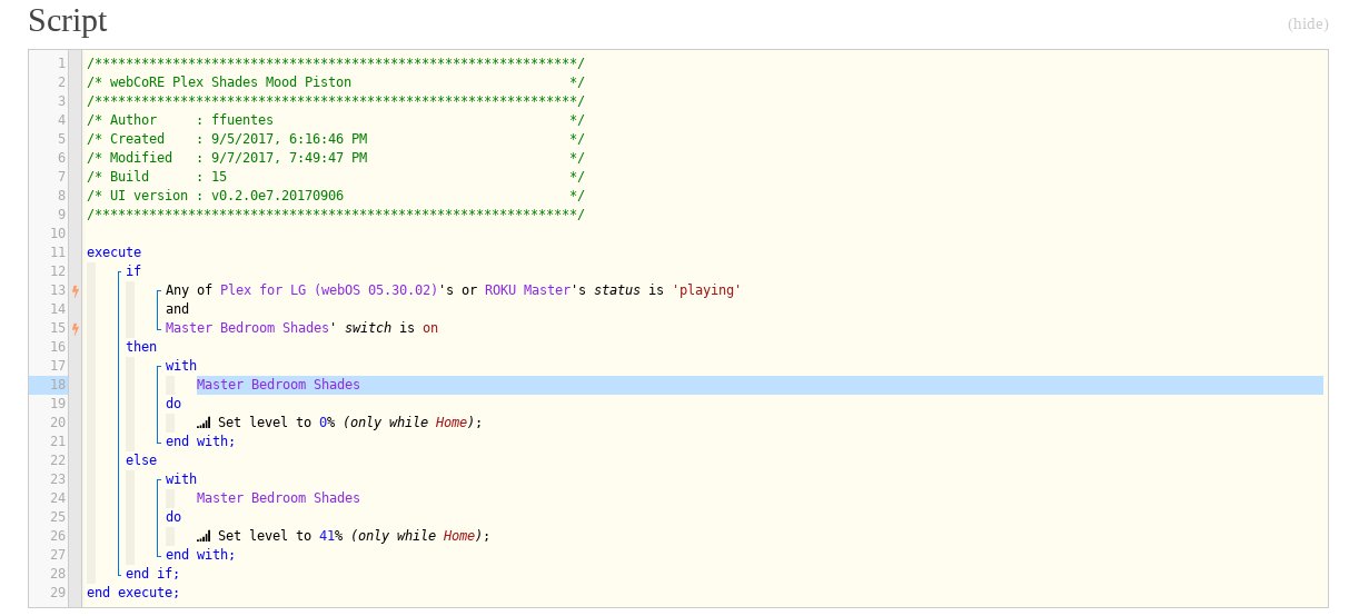

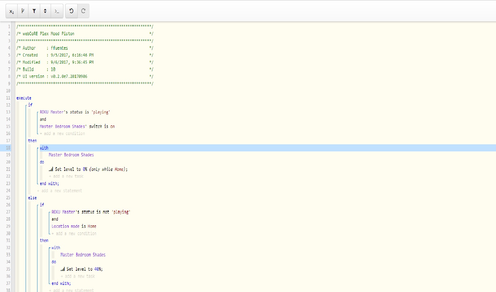

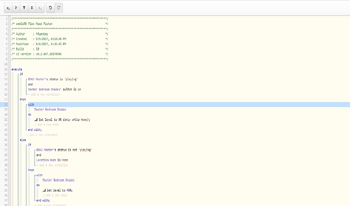

I created a piston that checks the status of my plex devices in my bedroom (I have two in my bedroom), If the device is playing than the piston closes my blinds.
Than if plex is not playing and is at a set time it opens my blinds up to a set level.
The problem is that the statements conflicts because I dont know how to sepearte a device so when I am playing a movie in my bedroom from one device but not the other the blind goes crazy trying to close and open at the same time.
I removed my second plex device so it does not go crazy…
Here is what I got so far:
Ideas welcome!

Bad news… Didn’t work… I figure because we are not stating otherwise… It just going straight to the next statement which say that if is home open… So still a no go… :frowning:
please share the latest snapshot. in piston view mode click the green button to get snapshot.

Well I thought I had a mistake but no… It behaved the same.

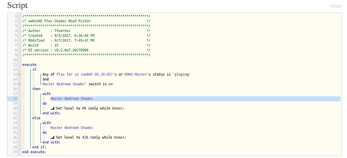

Here is what i got:
so, one of the 2 devices is playing and master bedroom shade switch is on but it is still executing the else condition? is that what you see in the trace?
which of the 2 conditions showed as evaluating false in the trace?
Here is what I got…
Not sure if this helps us find what you are asking?
Sorry for the noobnes :blush:

+1ms â•”Received event [Master Bedroom Shades].switch = on with a delay of 91ms
+495ms â•‘Piston waited at a semaphore for 255ms
+497ms â•‘Runtime (37135 bytes) successfully initialized in 298ms (v0.2.0e7.20170906) (495ms)
+497ms â•‘â•”Execution stage started
+563ms â•‘â•‘Executed [Master Bedroom Shades].setLevel (45ms)
+565ms ║╚Execution stage complete. (68ms)
+572ms ╚Event processed successfully (572ms)
9/7/2017, 8:01:55 PM +765ms
+1ms â•”Received event [Master Bedroom Shades].switch = off with a delay of 57ms
+506ms â•‘Piston waited at a semaphore for 258ms
+508ms â•‘Runtime (37130 bytes) successfully initialized in 322ms (v0.2.0e7.20170906) (506ms)
+508ms â•‘â•”Execution stage started
+566ms â•‘â•‘Executed [Master Bedroom Shades].setLevel (36ms)
+568ms ║╚Execution stage complete. (59ms)
+574ms ╚Event processed successfully (574ms)
9/7/2017, 8:01:55 PM +457ms
+1ms â•”Received event [Master Bedroom Shades].switch = on with a delay of 63ms
+198ms â•‘Runtime (37065 bytes) successfully initialized in 89ms (v0.2.0e7.20170906) (196ms)
+199ms â•‘â•”Execution stage started
+286ms â•‘â•‘Executed [Master Bedroom Shades].setLevel (62ms)
+287ms ║╚Execution stage complete. (89ms)
+298ms ╚Event processed successfully (298ms)
9/7/2017, 8:01:54 PM +877ms
+2ms â•”Received event [Master Bedroom Shades].switch = off with a delay of 53ms
+464ms â•‘Piston waited at a semaphore for 257ms
+465ms â•‘Runtime (37130 bytes) successfully initialized in 314ms (v0.2.0e7.20170906) (463ms)
+466ms â•‘â•”Execution stage started
+547ms â•‘â•‘Executed [Master Bedroom Shades].setLevel (56ms)
+548ms ║╚Execution stage complete. (83ms)
+555ms ╚Event processed successfully (555ms)
9/7/2017, 8:01:54 PM +593ms
+1ms â•”Received event [ROKU Master].status = playing with a delay of 68ms
+173ms â•‘Runtime (37062 bytes) successfully initialized in 75ms (v0.2.0e7.20170906) (172ms)
+174ms â•‘â•”Execution stage started
+268ms â•‘â•‘Executed [Master Bedroom Shades].setLevel (70ms)
+270ms ║╚Execution stage complete. (97ms)
+275ms ╚Event processed successfully (275ms)
master bedroom shade switch is on - why do you need that condition? i ask because if thats a typical shade switch, the switch should only be on while the shade is being adjusted, then it will turn off. thats why in my original snippet i had left that out.
dont worry about it. :slight_smile:
Well I am still learning so i figure that I need it to tell the system that the switch state has to be on so it can ignore it if its allready off.
I cant take it off and test? :smiley:
Thanks for been patient! :smiley:
Edit:
Ok I see your edit. Ill test.
Thanks!
yep, delete that condition and it should work :slight_smile:
EDIT: sounds good.
#15
Does this look right?
#16
does it work? :slight_smile:
#17
:slight_smile: :slight_smile: :slight_smile:
Yup! Work like a charm.
Thanks again!
