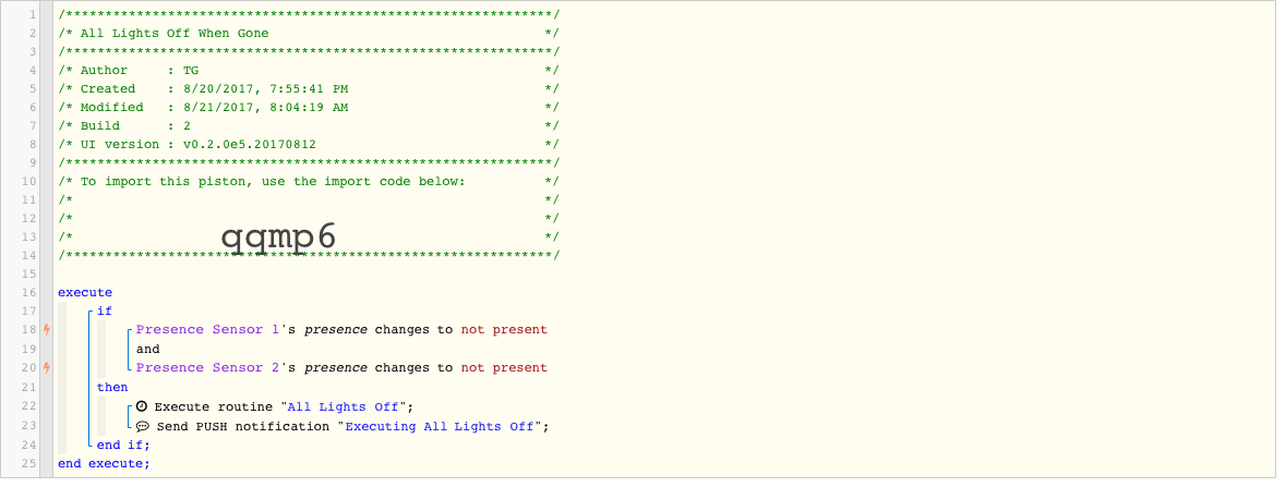

Fairly new to Webcore trying to learn it. Trying to make a piston that will run my “All Lights Off” routine when the wife and I go to work. Here’s what I tried but it didn’t work this morning. Any help appreciated.
Change the IF statement so that you select both present sensors are not present.
It should read:
If all of presence 1 and presence two are not present
Thanks! I give it a try.
alright. Shouldn’t have any problems if you make that change

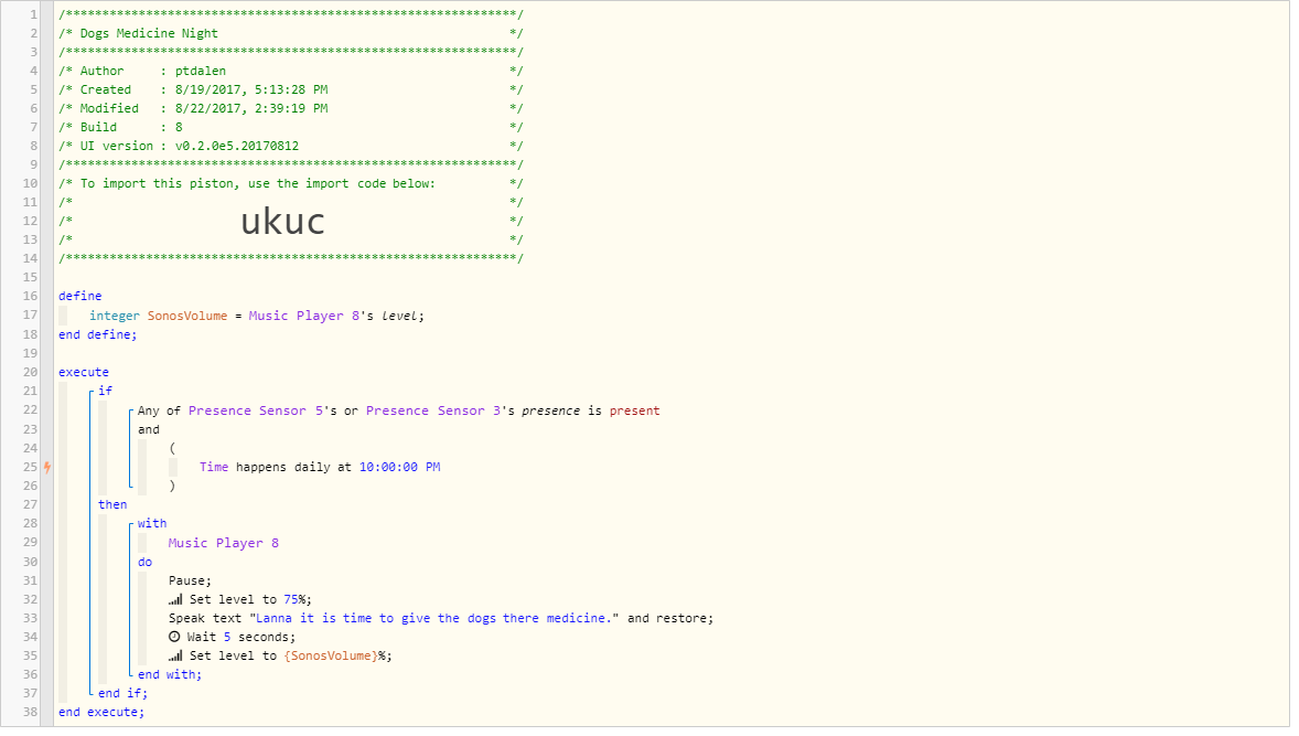

I have this piston which I imported and borrow but I would like to add a virtual dog presence and have it so that if dogs are not home the message will not play? I have been messing around with it but I’m lost when it comes to programming but trying to learn. If someone can point me in the right direction it would be appreciated. Thank
