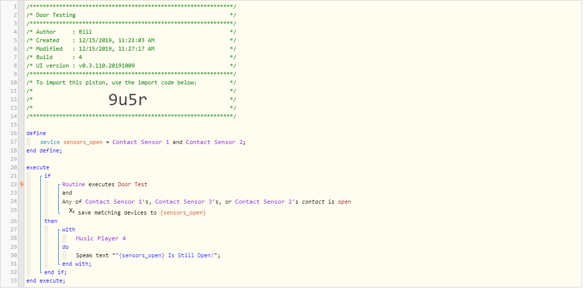

Hi all…very simple one here, kind of building on some other ones I’ve seen here and tried to get working.
I’ve got a simple piston going to where when I run a routine “Door Test”, if a door is open (Garage, Door from Garage, Patio Door, Front door) is open Alexa will tell me which door is open, and that’s working. What I’d like to add is something to the end where if they are all closed when I run the routine, I’d like her to say “All doors are closed.”
I know it’s simple, but the coding is still something I’m learning. Thanks for this great community!
It looks like you are executing ‘door test’ which triggers this piston. Why not just execute this piston directly? I think the simplest way to do what you want is to make your second condition (any contact sensor open) an indentured if rather than part of the top level. Then you can use your else for ‘all doors are closed’. like this:
