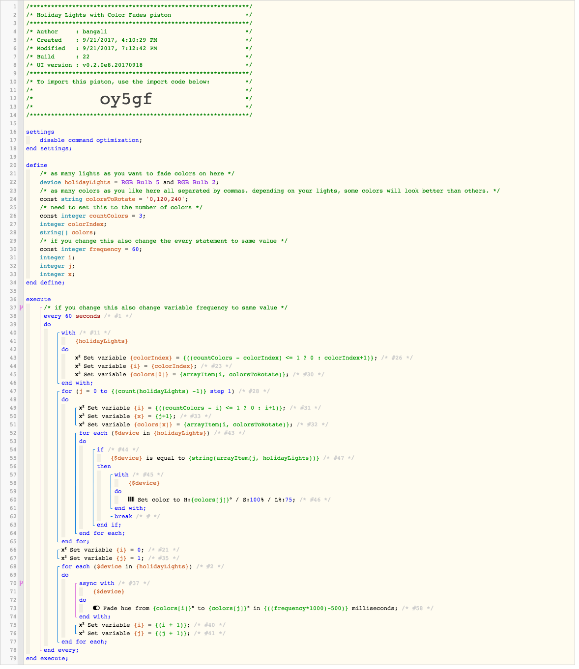

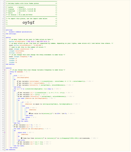

test hue transition with philips hue or similar bulbs. the piston works as expected though it is not fully done done. if you have philips hue or other colors bulbs other than osram and would be willing to test this piston on a few of those bulbs … please give me a shout. the three colors user here are RGB so best if its at least 3 bulbs.
hue transition works nicely without white fades in between.
hue transitions correctly but with fade to white for a few seconds in the middle of the fade. i use osram bulbs not sure if this is happening because these bulbs dont support the full range of colors and something like the philips hue bulbs would work better. or its how the fade to task works. or just a function of the hue color wheel.
