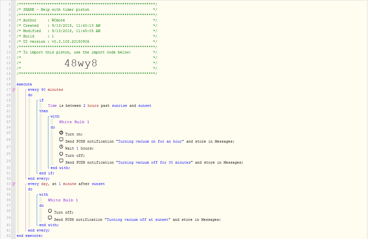

I’ve got yellow jackets living in the corner of my house. I’ve setup a shop vac to suck them out. It’s worked great thus far but I’d like to put it on a timer to not wear out the motor. I created a piston that I thought would work but apparently not.
Between sunrise and sunset, turn vacuum on for 1 hour, turn off for half hour.
Vacuum turns on but only turns off after sunset.
This is difficult at the moment since it take over an hour to see if it’s working and I’m currently at work.
