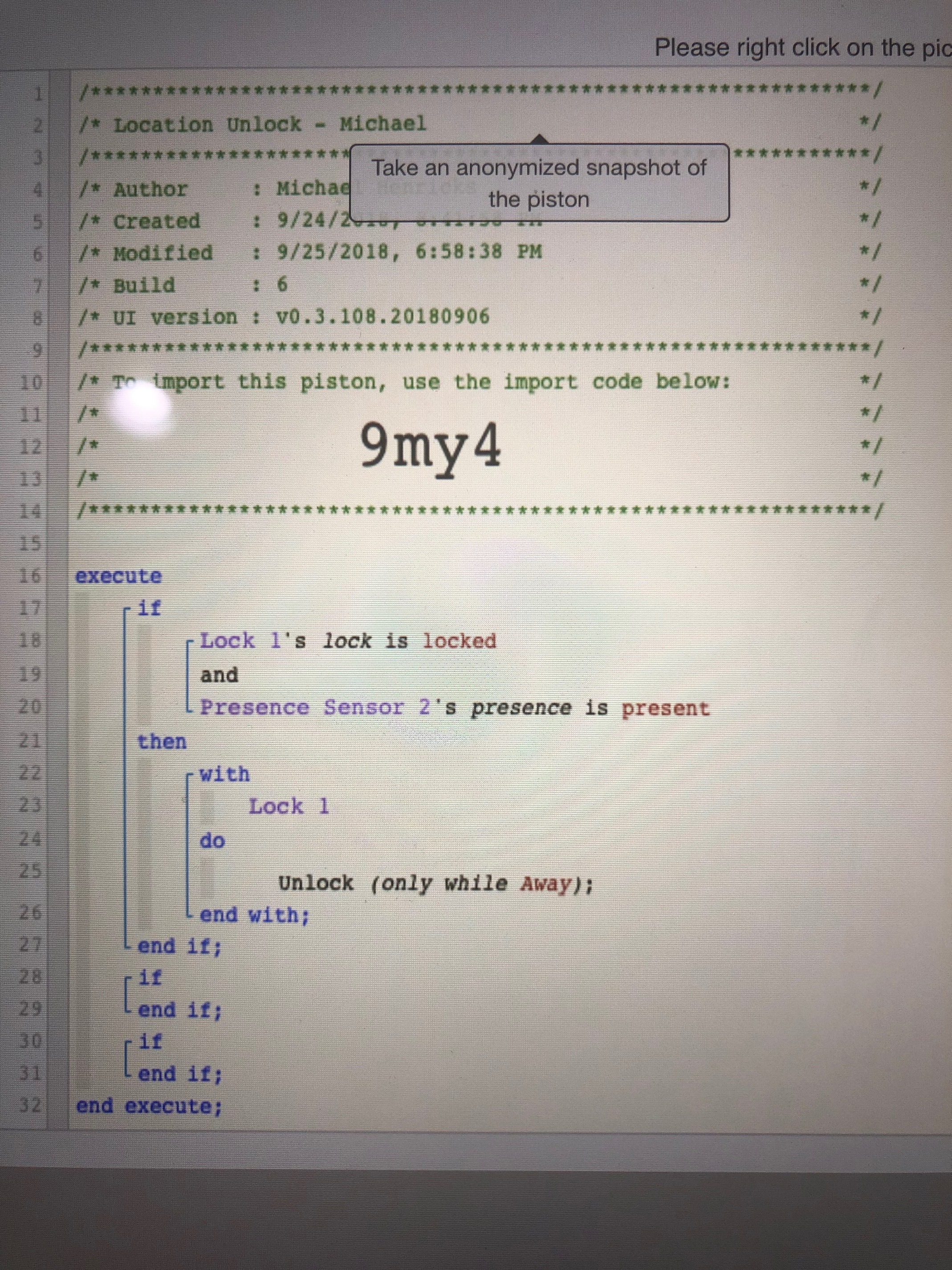

I set up a piston for my wife and I so our Yale lock unlocks when we arrive home. I currently have it set so that it does this when the system is in “Away” mode.
The piston works great and as expected, however I am trying to tweak it so it works even if the the “Away” mode isn’t set.
So, when I get rid of the “Away” aspect, the lock will not stay locked when either of the phones are here. Obviously this could be an issue at night, lol.
Is there anyway to set this up so the door will unlock when the door is locked and when one of us is arriving, but not unlock if the door is locked and one of is here? I have been playing around with it, and am new to WebCore, so I am at a lost.
I apologize in advance if this has been discussed or is so easy I should be seeing it. I do appreciate the help and thank you in advance!
You need to change the execute to be:
if Presence Sensor 2's presence changes to present
then
    with Lock 1
    do
        Unlock()
    end with;
end if;
That should fix it.
That absolutely fixed it! I greatly appreciate it!
