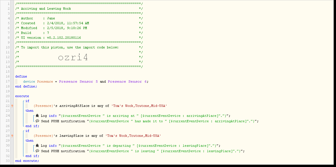

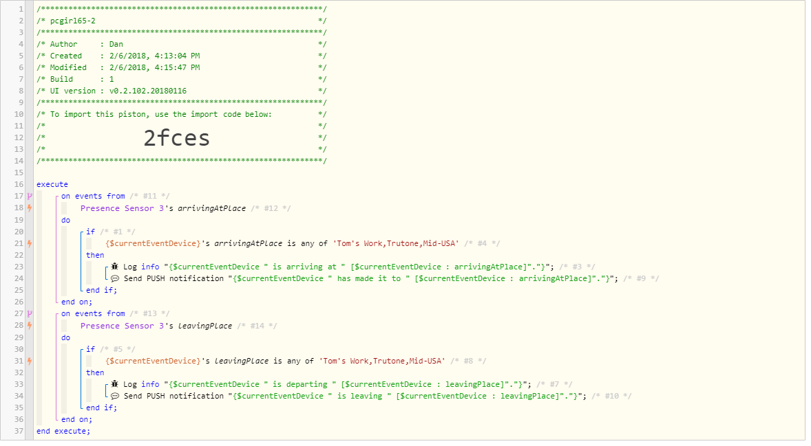

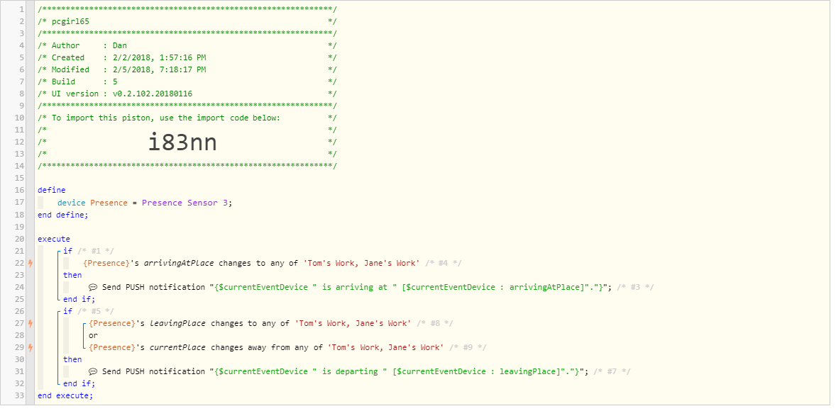

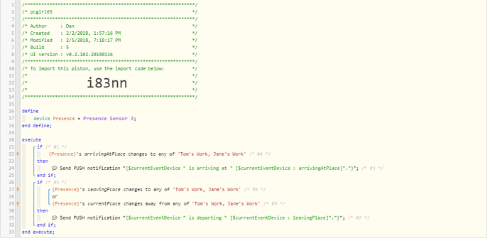

Help with using multiple locations in a variable
Interesting. Were there any events after that in the log? According to that, leavingPlace only triggered the piston one time at 12:12:31, and since it was blank the piston (rightfully) ignored it. There wasn’t an instance where leavingPlace = Tom’s Work?
Yeah I noticed that also. It should have triggered him leaving as I have the ST presence sensor still setup and working as I test this one. It notified me that he had left work but this one didn’t.
As a workaround, we could change the departing statement to "if currentPlace changes to “” ". In the meantime, I’ll set up a piston to log leavingPlace and a few other variables on events so I can see if mine behaved the same or if the failure today was a fluke.
Another thing to keep in mind is that I only want it to send a notification for when we get to our work locations and leave our work locations. I don’t want it telling me when we leave and get home because I already have that piston setup.
This should meet what you want. You’ll have to edit if the places typed in don’t exactly match your locations as saved in ST.
The departing IF statement has two conditions - either of these should work on their own, but I included an alternate approach since you didn’t get a message when Tom left work today. Using them both may result in duplicate messages due to timing differences of the two parameters changing:
Yes, I think this is what I was trying to accomplish without having to use a whole pile of IF statements. I will see if this works tomorrow. I just put in the first IF condition for the leaving work. Let’s see how that goes. Thanks for your help!
Well we are not quite there yet. This morning when Tom left home the notification said Tom has left Tom’s Work. So for some reason, it had currentplaces as Tom’s work.
I’m thinking that was the presence sensors fault, not the piston. Since Tom sensor never triggered yesterday for leaving work, his current place still would have been work.
Can you grab all the logs from today and post them? Did it work correctly when he arrived at work?
No, his presence sensor did have him at home because I got the notification. When I left this morning it said that I left 4 times, but I don’t have it notifying me when I leave Home. It also just said Jane is leaving . Then when I made it to work it didn’t notify me even though my presence sensor says that I am at that location. Here are the logs from this morning:

Here is the current piston:

Since you only have a couple presence sensors and locations, we can simplify your piston to this and you won’t get anymore duplicate notices. Just click on the “on events from” statements and add both presence sensors and you’re done. I only had one to add, but everything else will work with multiple selected.
Thanks, I will try it. Sorry for not replying but all the emails from webcore.co are being directed to my quarantine file and I don’t see them until the quarantine email comes in at night. I have set my email account to accept these emails, but it still doesn’t. Technology!?
