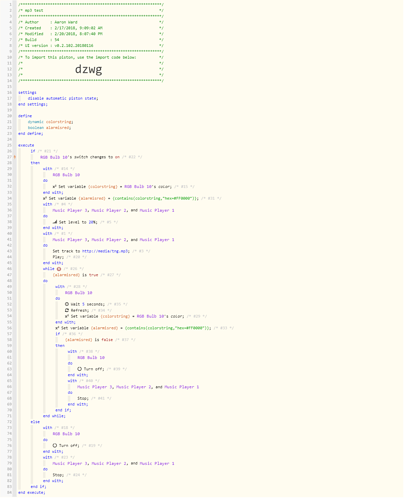

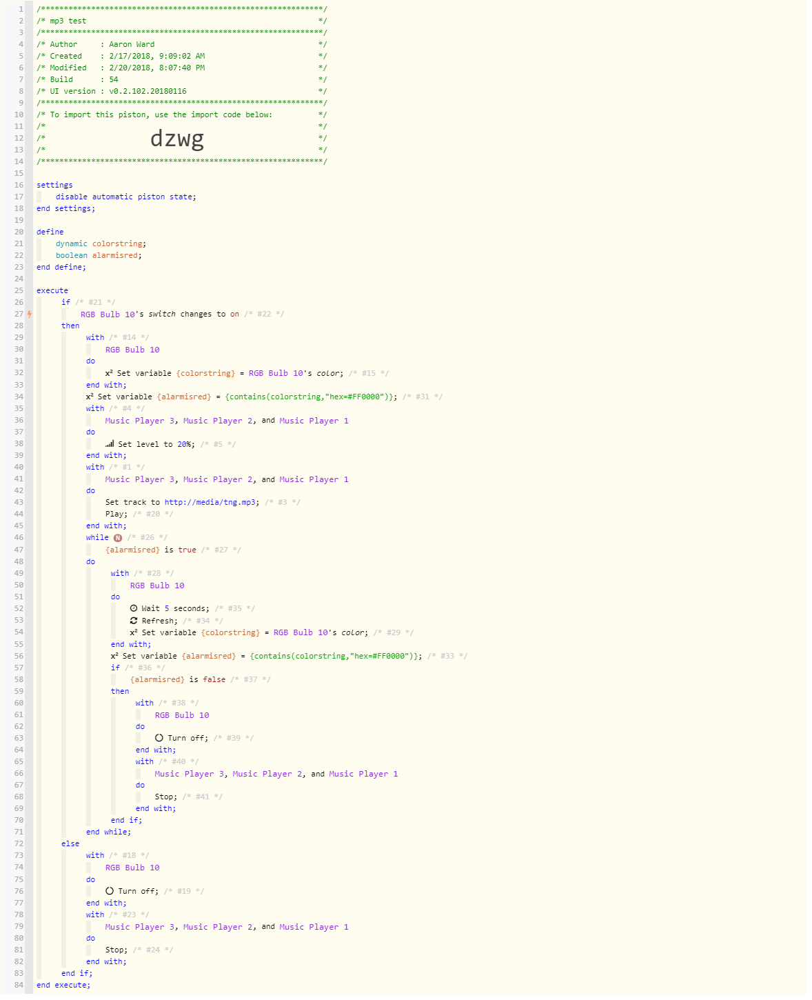

Help with WHILE statement or more efficient code
While statement seems to work correctly if I execute a separate piston changing the simulated testbulb color from red to white. SHM initiates the color change and piston works but WHILE statement seems to not catch changes when SHM changes RGB light to different color.
Piston waits for trigger of simulated RGB testbulb to change switch to ON. When SHM changes simulated testbulb to Red (which also turns switch on) the piston starts, initiates media players throughout home. Piston loops checking the simulated RGB testbulb for color change. When SHM changes simulated RGB testbulb to any other color (typically white) piston then should stop checking, stop media players and turn off simulated RGB testbulb light.
Piston begins but doesn’t see the color change from red and doesn’t stop.

All looks a bit complicated to me…
Why not just:
IF
RGB bulb is red
THEN
With audio
Set volume
Play x
ELSE
With audio
Stop
With RGB bulb
Turn on
The issue is you can’t get the color info you need. See the logs above. When acquiring the color information you get back a ton of extra information and not just the color hex.
Can you show me a log event for a color change, not switch event
Just make a piston:
IF
RGB color is red
THEN
log info $currentEventValue
It is in the Graph IDE image. SetColor [hue:100, saturation:100, level:100, color:#ff0000]
That is the string you get from the simulated RGB bulb. If I do this with a regular RGB bulb and ask for color it comes back correctly for an “if” statement. BUT I do not want to have a regular bulb plugged in to do this. The Simulated RGB DTH is giving this info back incorrectly in ST. Hence why I need to parse the string with a contains first and also why I can’t trigger based off of just color changing.
Try using a non-simulated device handler, in a simulated manner.
For example, try the ST default handler for Fibaro RGBW (the second one in the list).
I have. SHM will not set its color unfortunately. :frowning:
I believe I am going to call ST today and discover what is going on.
Is there a particular reason why you are using a simulated RGB over a simulated switch?
You only appear to be referencing two states (red and white) so why not on / off?
SHM doesn’t turn the light off unfortunately.
