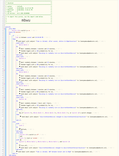

I found a nice piston on these forums that I imported and modified to my needs yet it doesn’t seem to do anything at all.
Randomly turn on lights/tv, send an email when things turn on or off.
Nothing is happening … at all.
( |+1ms|╔Received event [Home].test = 1538313480001 with a delay of 1ms|
|+86ms|║RunTime Analysis CS > 19ms > PS > 36ms > PE > 30ms > CE|
|+89ms|║Runtime (51399 bytes) successfully initialized in 36ms (v0.3.108.20180906) (87ms)|
|+91ms|║╔Execution stage started|
|+107ms|║║Comparison (enum) on is (string) on = true (2ms)|
|+109ms|║║Condition #18 evaluated true (11ms)|
|+111ms|║║Condition group #1 evaluated true (state did not change) (14ms)|
|+156ms|║╚Execution stage complete. (66ms)|
|+160ms|║Setting up scheduled job for Sun, Sep 30 2018 @ 9:46:22 AM EDT (in 1702.735s)|
|+173ms|╚Event processed successfully (173ms)|
