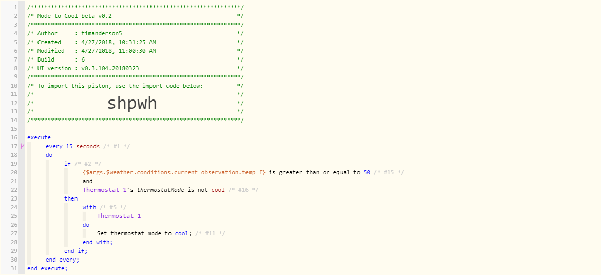

Honeywell Thermostat Change Mode to Cool
Cannot get Piston to execute as desired
**2) What is the expected behavior
When temperature is >= X’ f
And when Honeywell Thermostat is not in Cool Mode
Change Thermostat Mode on Honeywell Thermostat to Cool Mode
Change is not happening

What is being returned by your $args.$weather… line? It returns false every time it’s compared to <= 50 (and it’s compared as a dynamic value, not an integer).
Can you store that value in a variable or log it to the console so we can see what’s actually being returned? Should be able to sort it out from there…
Hi @michicago
Thanks for responding.
I’m a newbie, and am not sure how to capture the value being returned. Can you give me some instruction on capturing the value?
The argument I used came from: https://wiki.webcore.co/Weather#Conditions
Temperature - Fahrenheit
Syntax
$weather.conditions.current_observation.temp_f
Returns a decimal of the temperature in fahrenheit.
Example
71.1
Thanks!
Glad to help! Not sure how $args. got into your code, but set your IF condition to ‘expression’ and paste the string in exactly as you have it below.
If you have any questions, post up here again and we’ll sort it out.
That fixed it. Thanks
