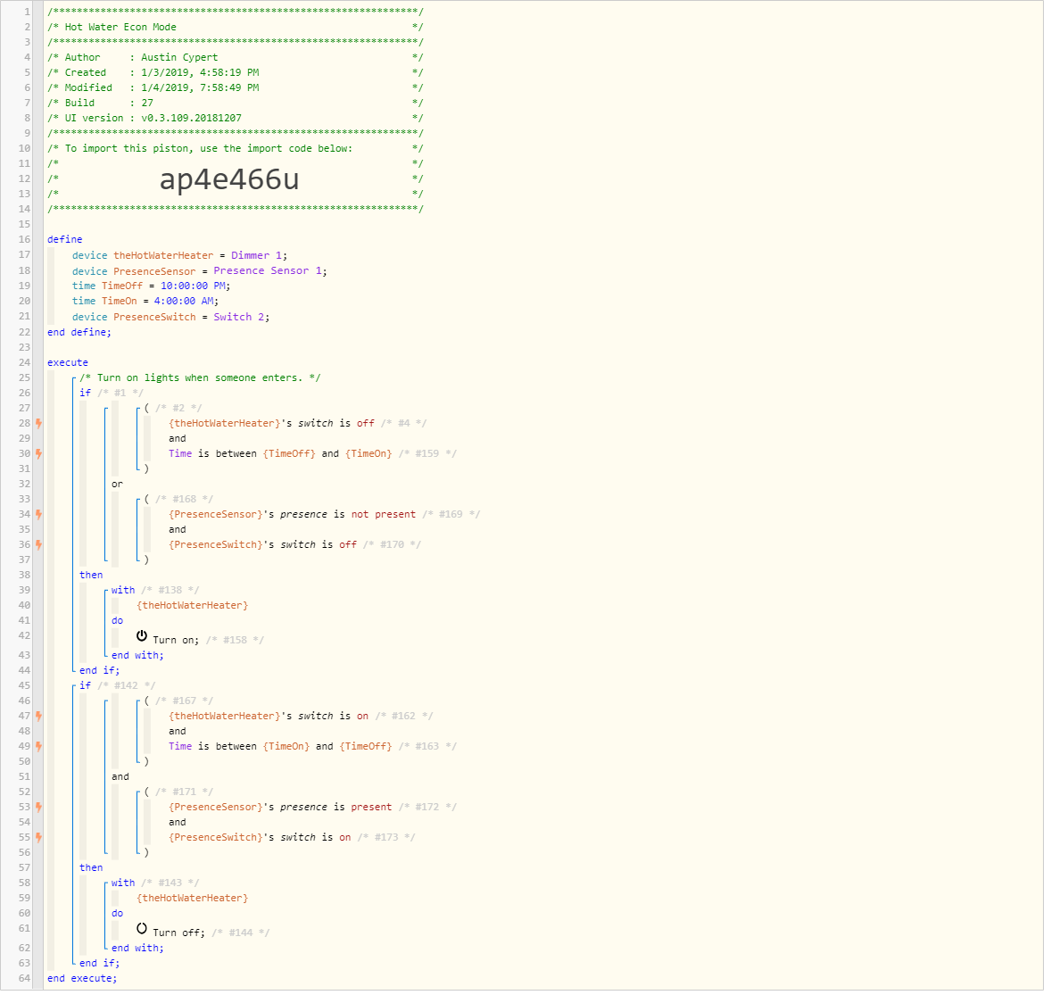

Timer seems to be working properly and also once i arrive home the hot water will kick out of econ mode. but for some reason once i leave during the day the hot water program will not go into econ mode.
Hot water heater to go into econ mode when during the day while I am away.
Defined in " **1) "

What changes the presence switch? If the presence switch is triggered by another piston to change when you leave/arrive it could be that one condition is met before the other gets updated. I am not sure what the purpose of the presence sensor and presence switch are but unless properly coordinated and somehow both changed before this piston runs it will likely show false for one or the other condition. The timers are easy and will always work.
