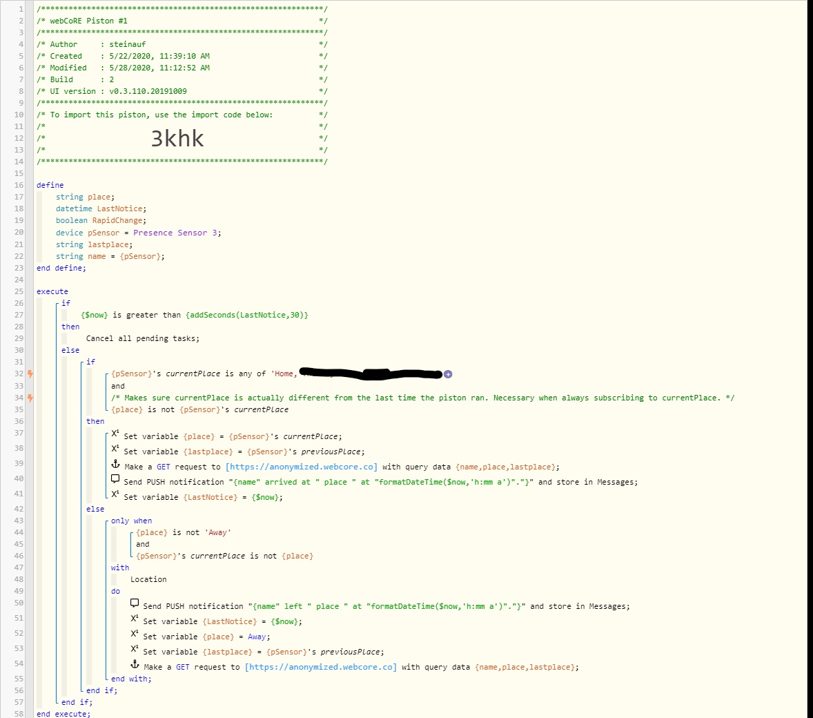

How can I compare an empty/uninitialized datetime variable?
My piston defines a datetime variable called LastNotice and does not assign it a value. In the local variables list, it displays that this variable is “Invalid Date” in light grey text. It’s not null or blank.
I want to compare $now to this variable to prevent my piston from running too often. I need some way of initializing it once, because then it will retain the value and run properly.
I’ve tried a few ways of doing this, comparing the integer of $now and my variable which hasn’t been set. The log tells me that it compared two integers, which baffles me because how is the value for my LastNotice variable derived?
I can’t seem to compare it to null or a blank value either, since it always comes up with some integer value during these comparisons. So I haven’t been able to check if the variable doesn’t have a value, since it somehow does when the piston is run.

I was hoping to avoid that so I could share my piston with people and not have to tell them to set the variable in order for it to work.
However, I was helped in the facebook group to find the answer to my problem in this thread. apparently an unset datetime variable will default to = $now when a piston runs, which was my problem. fortunately, since i’m just comparing the integer values anyway, i simply changed my variable type to integer. since it defaults to 0 when unset, it allows my piston to run normally the first time. Worked perfectly.

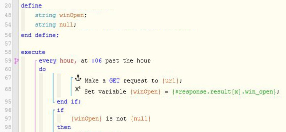

Not tested with datetime, but I sometimes cheat and use a second (empty) variable to achieve this:
pic
