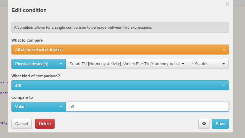

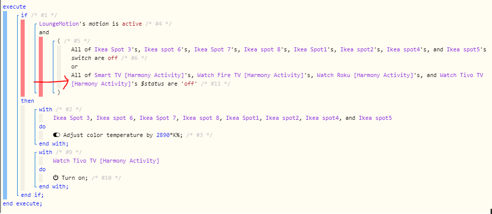

Hi, someone mentioned you can get the status of harmony activities, can I get some pointers (I’m afraid I can’t figure it out)
I’m using Webcore and the aim is to have a motion sensor above the door, if this is triggered and (any of the lights are off OR all of the harmony activities are off) then switch on the lights and harmony activity TV on.
The rest is working but not the checking of the status.
#16
Choose switch instead of status
