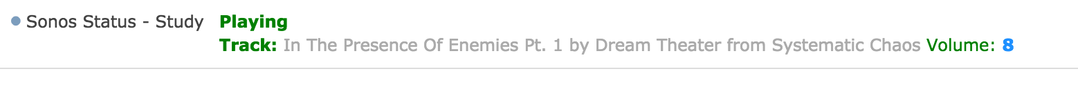

Example result of above when [ or ] are in trackDescription:

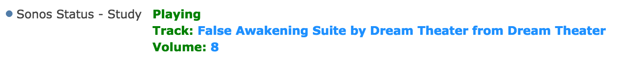

Example with no brackets in the trackDescription:
