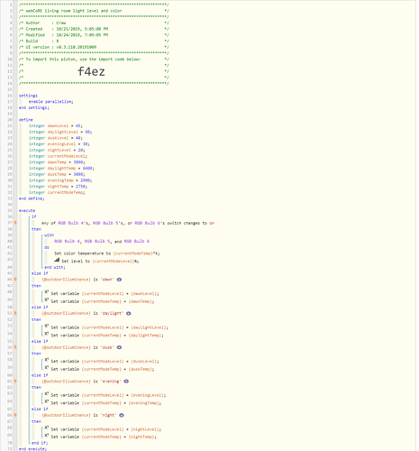

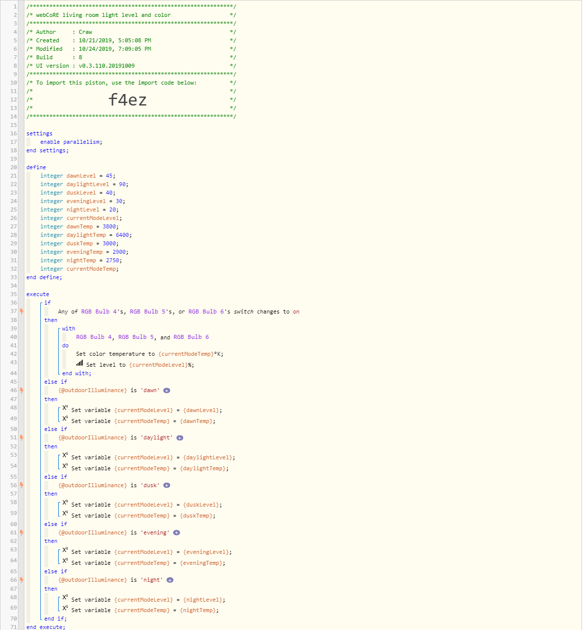

I have a piston to adjust the brightness and color of my lights based on time of day using variables, I need to make the piston adjust the lights if they are on when the variable changes.
I2) What is the expected behaviour?
The piston works as intended, I just want to refine it, and i’m not sure how to go about getting the expected results.
If the lights are already on when the variable changes the lights do not adjust to the settings that match the new variable. Im guessing i need a way for the lights to poll the variable and adjust to changes, but im not sure.
