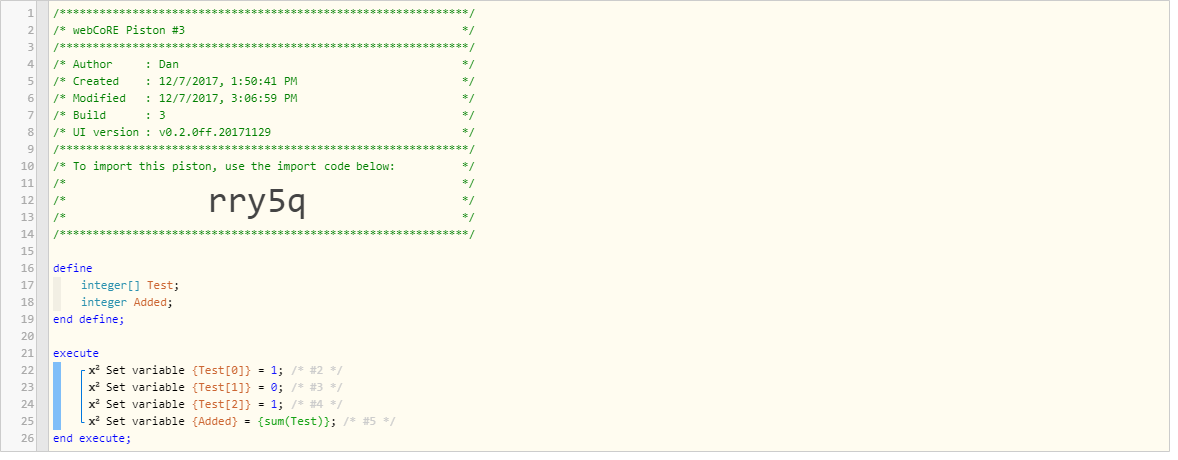

I want to sum a list of integers but it’s not working.
Added should = 2 after execution.
I’m doing something wrong but I don’t know what… everything I looked up online appears adding a list of numbers should be this simple.
Rather than clouding this with the complicated piston I’m trying to get to work - I’ve made this one to demonstrate the idea of what I’m trying to do. Note after execution the Added value was set to zero:
Functions are not aware of lists

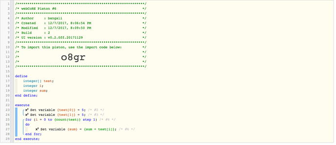

sure you can. here you go:
That’ll work, thanks @bangali!
