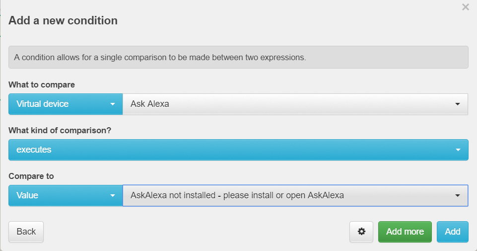

How does Ask Alexa interface with webCoRE?
Trying to figure out what webCoRe can actually do for AskAlexa

I was trying to integrate Ask Alexa and WebCoRE and had the same question after I saw Ask Alexa as an option in WebCoRE’s list of virtual devices. I reached out to Michael Struck (he developed Ask Alexa) about this and he said it’s his understanding that implementation of WebCoRE’s integration between WebCoRE and Ask Alexa is still a work in progress and WebCoRE doesn’t support it yet.

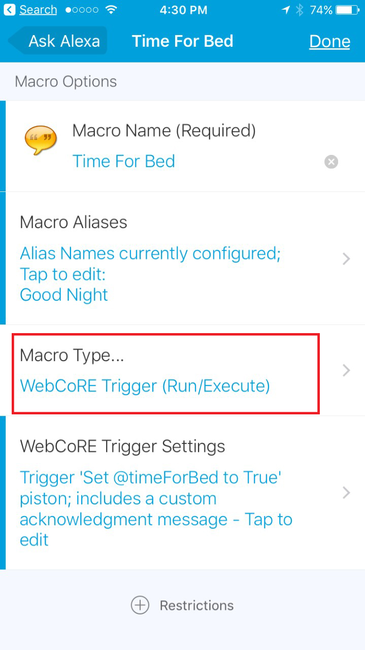

What I ended up doing is using Ask Alexa voice commands to fire WebCoRE pistons (one of the Ask Alexa macro options is Run/Execute WebCoRE Trigger). I have a piston that turns off the inside lights and turns on the outside security lights when I tell Alexa to “Tell the house goodnight.” I created another one that will turn up certain lights if I tell Alexa to “Tell the house to lighten up.” It’s good when someone is cooking and needs more light in the kitchen prep areas. I have others and really like the ability to use Alexa to fire off pistons that can do complex stuff.

This is the current code block for the Ask Alexa integration. Still a work in progress.
private Map getAskAlexaOptions() {
return state.askAlexaMacros ?: [null:“AskAlexa not installed - please install or open AskAlexa”]
To me this is not enough information to make any sense. At least at this time.
There is no integration yet

I am trying to create a WebCoRE piston which will execute when Ask alexa macro is triggered. I get a message that Ask alexa is not installed. Am I missing something?
Use Ask Alexa to run pistons. If you go into Ask Alexa’s macros, one of the things a macro can do is Run/Execute WebCoRE trigger. I’m using Ask Alexa to trigger a bunch of WebCoRE pistons and it works well.
Thanks guys. Michael explained this on the smartthings forum. I am trying to do something which is not actually possible. as @markplewis mentioned, I can call a webCoRE piston from an Ask Alexa macro.
