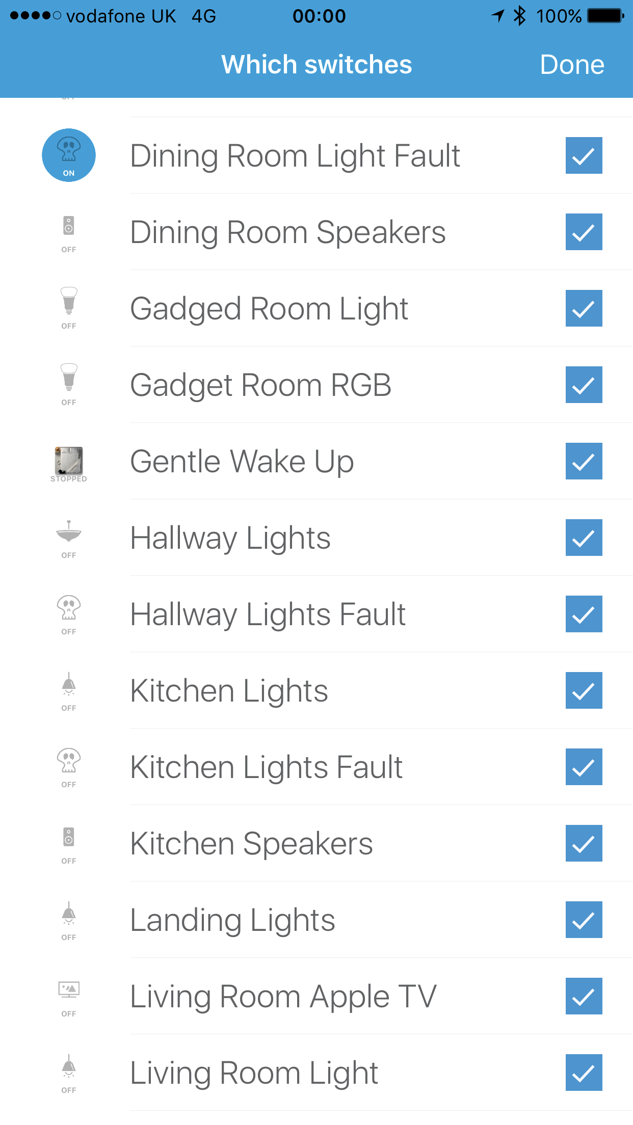

However I can’t figure out how to expose this controller / switch to webCoRE. Normally I would go to webCoRE settings and select Available Devices and Contacts and then I expect to find it in Available Devices (actuators or sensors). However it doesn’t show up in any of them. How can I expose this so that I can write my own Piston logic to trigger this “switch” to turn on when conditions are right?
try under switches or timers in webcore settings, probably one of those two.
It’s under switches.
Thanks guys! Yes I found it under there, thanks to your guidance. To date all my devices shows up in the Actuators or Sensors list. I looked through the other choices, but not closely enough apparently. :embarrassed:
