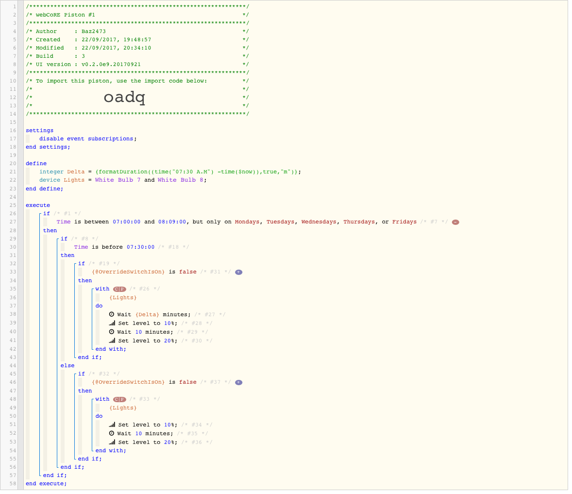

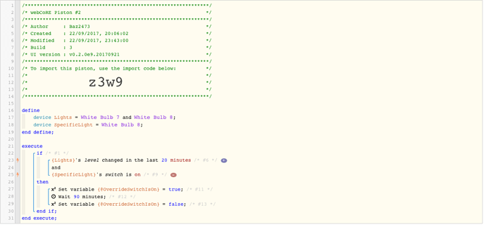

Ah. I think I’ve worked it out. Did u mean you want your first piston to activate the second one. And also to cancel it if the conditions in the first piston happen again?
Give this a go.
Create a global variable called.
@OverrideSwitchIsOn
Then import these two pistons and modify the variables to match your lights and sensors.
I’ve made this on my cell while at work. Might be worth trying it before you commit to it. Because obviously I haven’t tried it. But it looks like it could work how you want, if I’ve understood what you meant???
UPDATED Don’t forget to run it once first to setup the variable correctly. Or use the soft edit function. Don’t hard Code a value to the variable or it will always reset back to that value upon every run.
