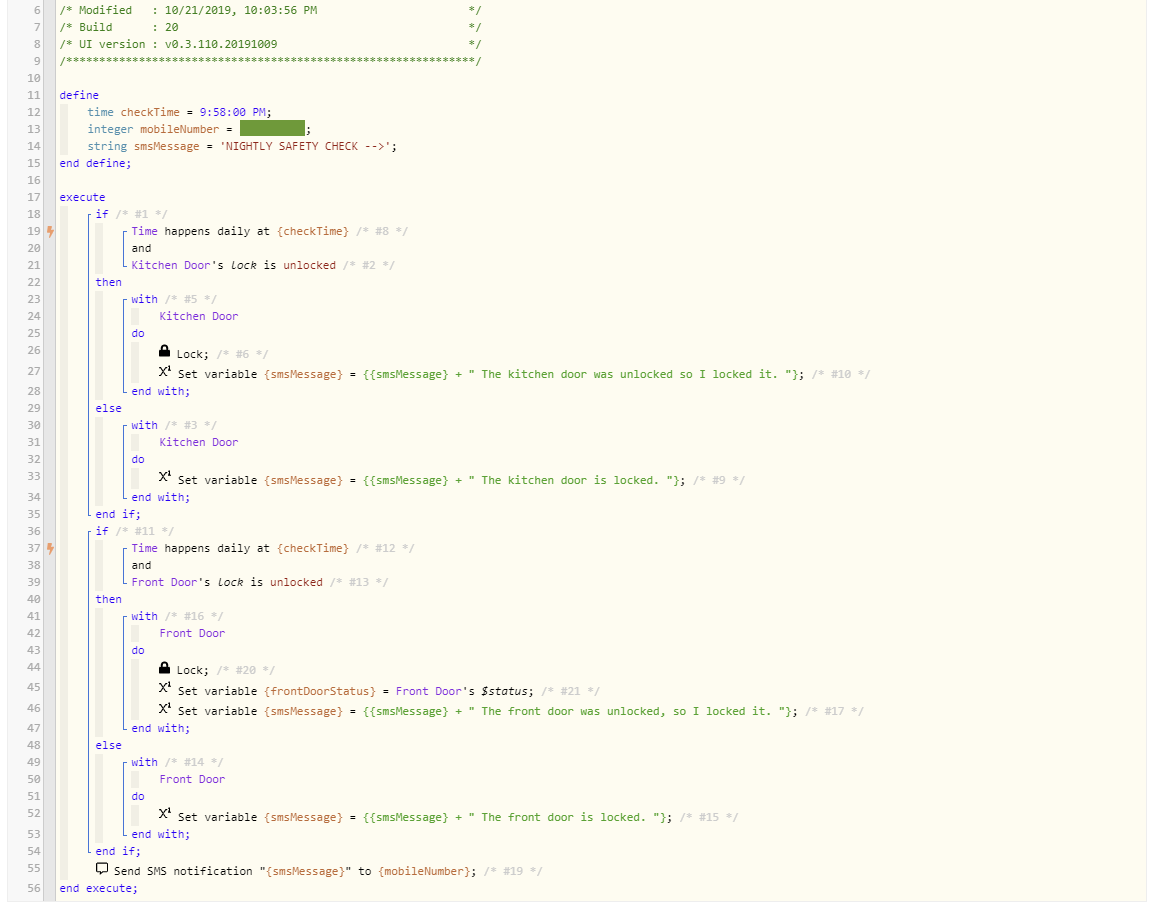

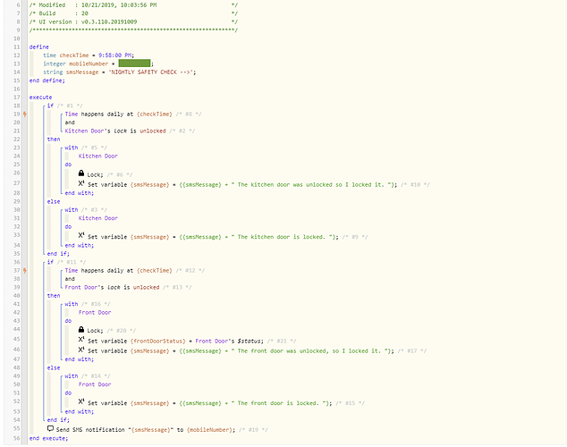

I’m trying to create a “Nightly Safety Check” piston with 2 door locks. I tested the piston and it correctly sees the status of the kitchen door, but it incorrectly sees the status of the front door?
The piston should correctly see the status of both door locks.
The front door is unlocked but it sees it as locked?
4) Please ignore line 45, I forgot to delete it. I was trying different code.
