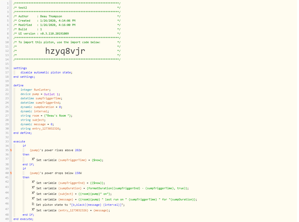

Hi All,
this is used with a sump pump I like to do it without using the 200w and 150w
as I am not sure what the amps are could I just us power on change

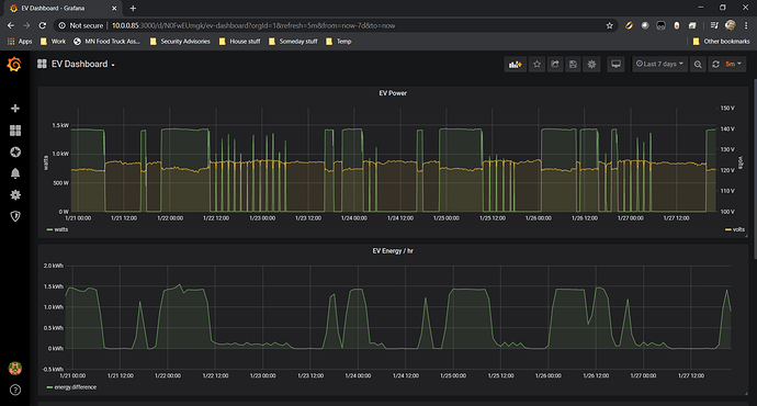

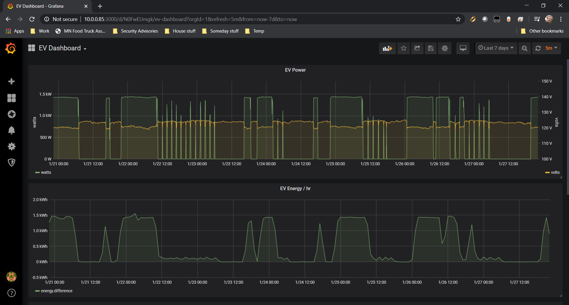

Here’s screenshots from influxdb/grafana:

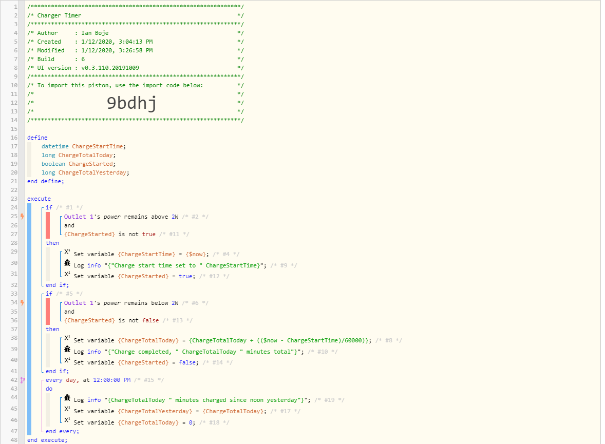

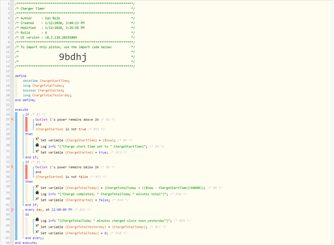

Here’s my activity monitor:

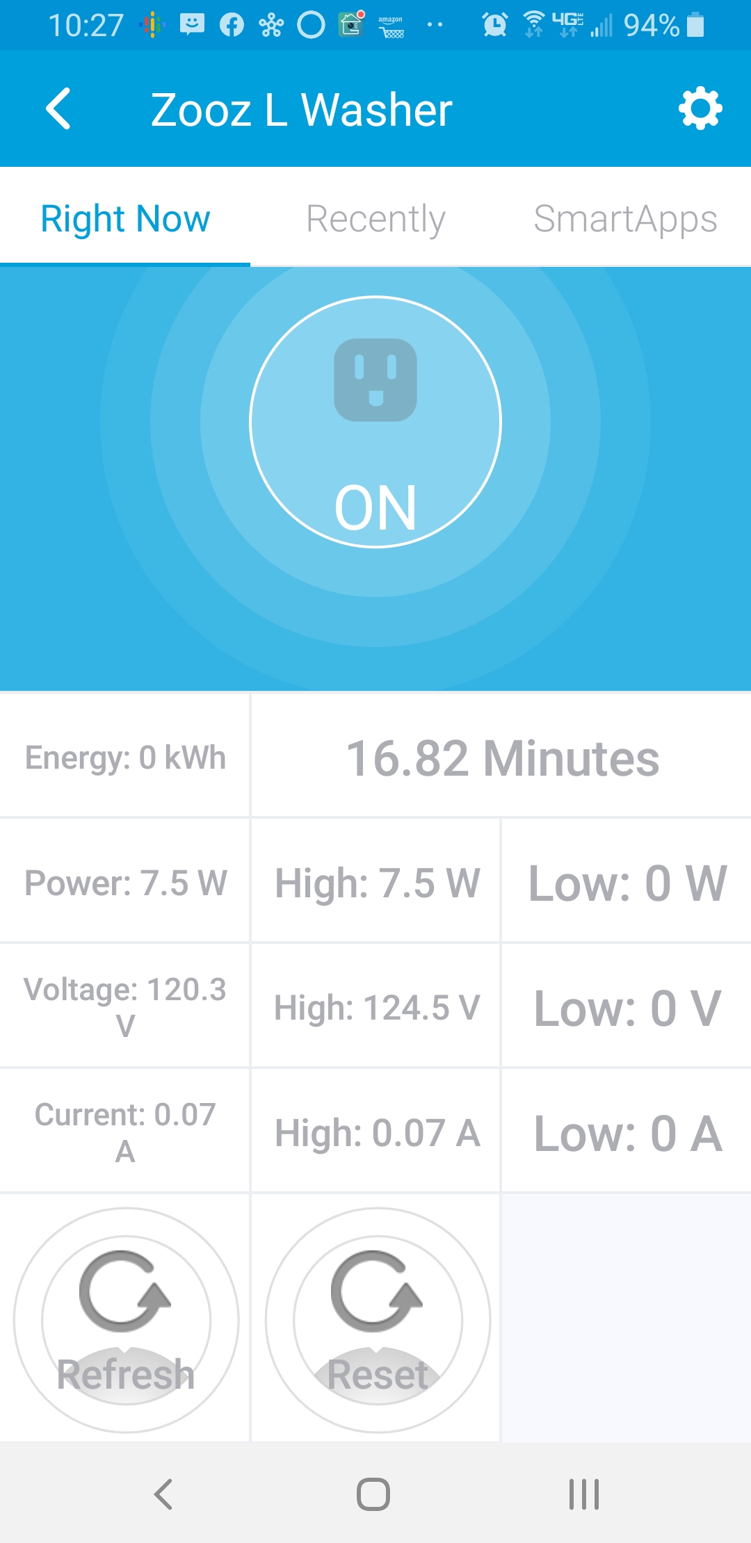

For my energy monitor, I’ve got a zooz zen15. It’s supposed to be rated for 15 amps, and the charger is only 12.
