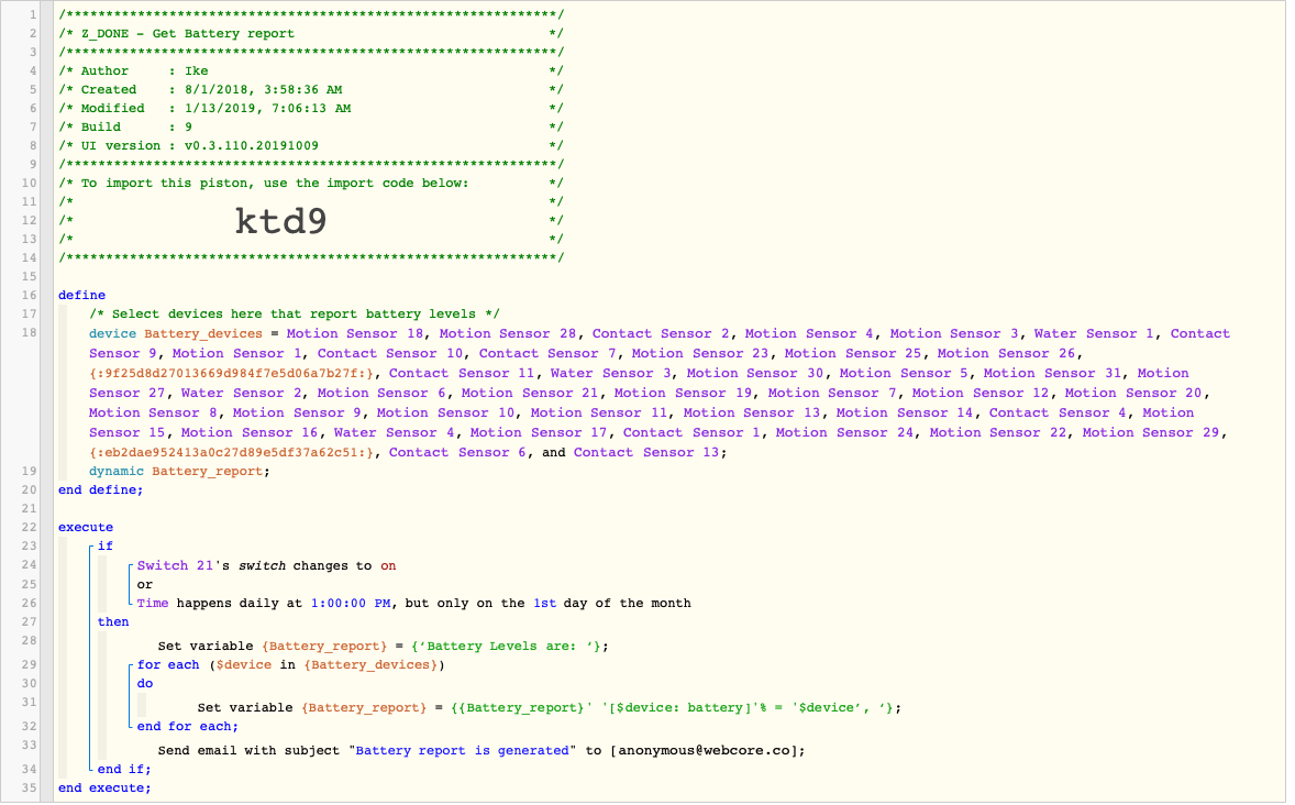

You need to use variables for this.
let me give you an example from my pistons…
BRB
there you go…
Here is an example variable with all devices I want to include…
and if you want them outside of the piston but still in webcore, use GLOBAL VARIABLES…
Wow. Simple as that! Thanks very much, completely solves my problem!
