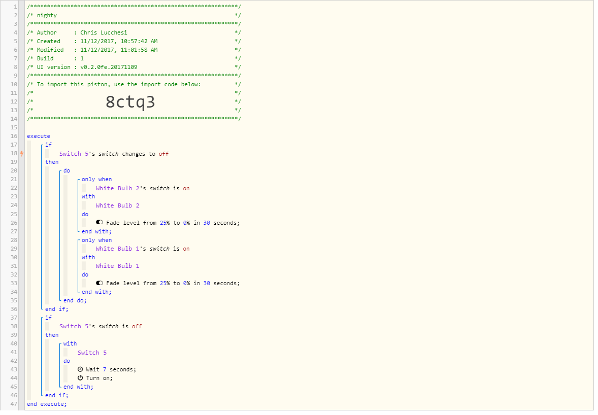

I am trying to get light 2 and light one to fade to zero starting at the same time, but only if light 1 or light 2 are on first. I have turned on trace and see that it will fade light 2 first than go to light 1. How do I correct this so that they will both fade at the same time? Thanks for all the help!
If you don’t want to change the structure then make the first action asynchronous
How about putting Light 1 and Light 2 into both WITH statements.
Isn’t that what you are trying to do?
Thanks c1arkbar, that worked, its not perfect 100% at the same time but close enough!
You could also combine the statements as mentioned by @bobbles This should start the actions at the same time. Lots of ways to do the same thing
So i started with putting both bulbs in the same with statement, the problem is that I do not know how to say that only control bulb 1 or 2 if bulb 1 or 2 are already on. What issue issue I was running into was that if bulb 1 was on and 2 was not when the piston is triggered it would turn bulb 2 on. Im trying to get just the bulb either 1 or 2 or both if they are already on to fade out, if either one is already off I dont want anything to happen to that bulb. Thanks again for all the pointers!
Ok a lot of times I see those restrictions and assume people just threw them on there trying to accomplish their goals. Definitely keep them split and use asynchronous.
Will do, thanks again, worked fine last night, no delay!
