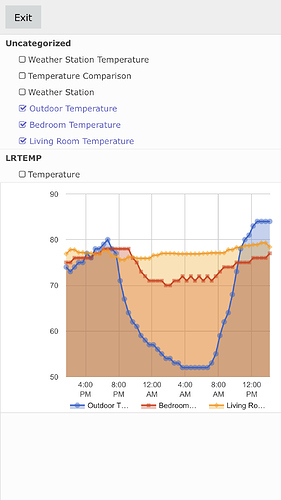

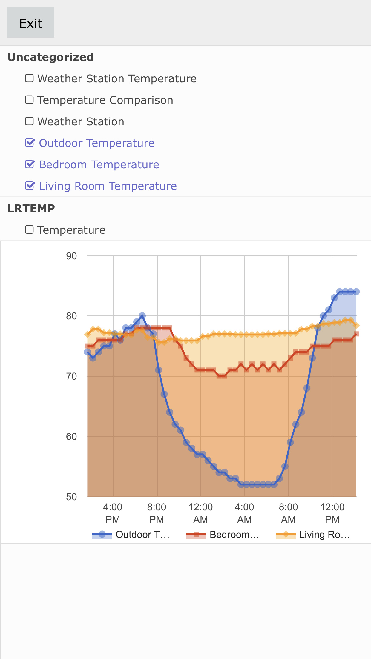

Perhaps I’m being a bit greedy and asking too much but is there anyway I can include a switch in a fuel stream and have it indicate whether it’s on or off? I’m trying to chart temperature data and would like to show on the chart whether my air conditioners were on or not.

Although, for ease of reading, I often make those numbers 0 & 100.
(especially if you want to see that data at the same time as the temp in your pic above)

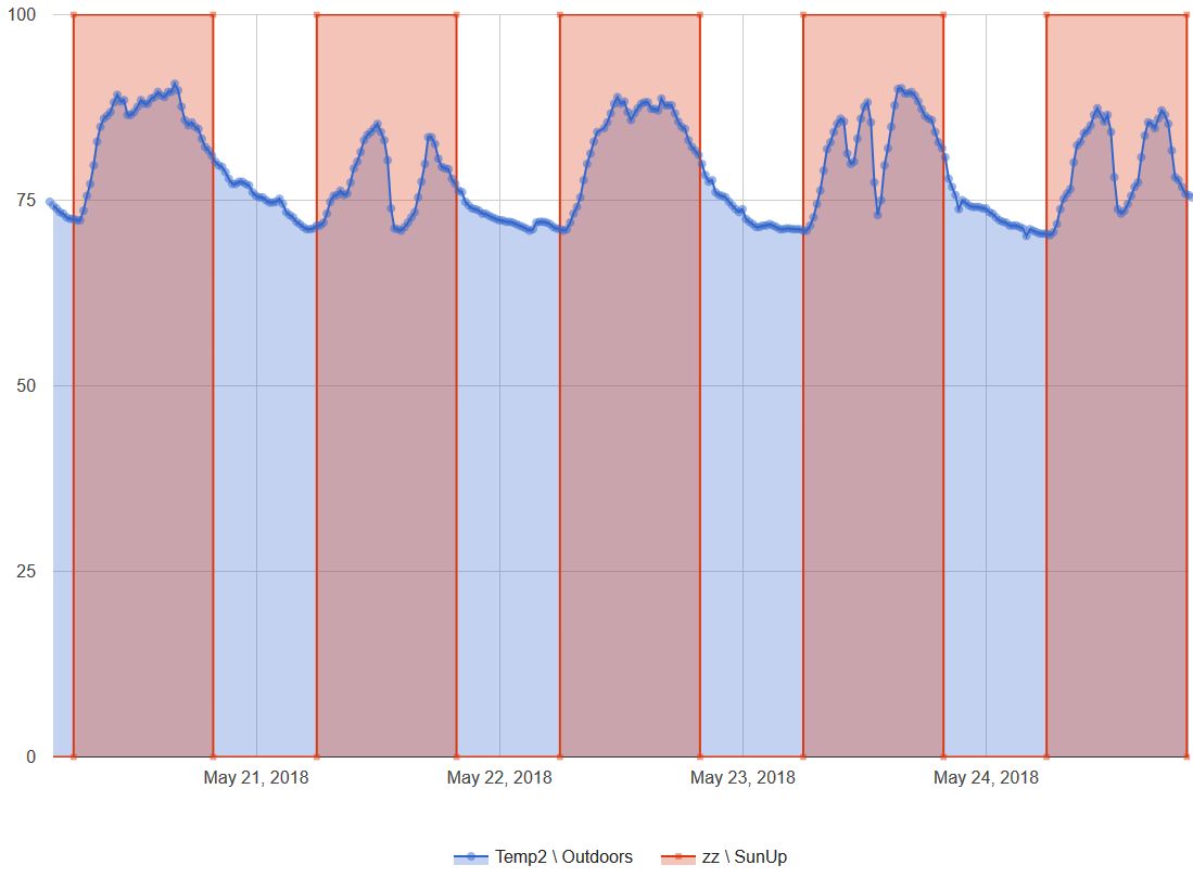

Here is an example of me monitoring the temperature as well as the sun up time:
(I am tempted to make 50 the ‘off’ number instead of 0, so the graph zooms in better)
