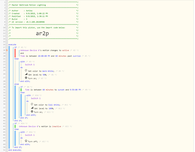

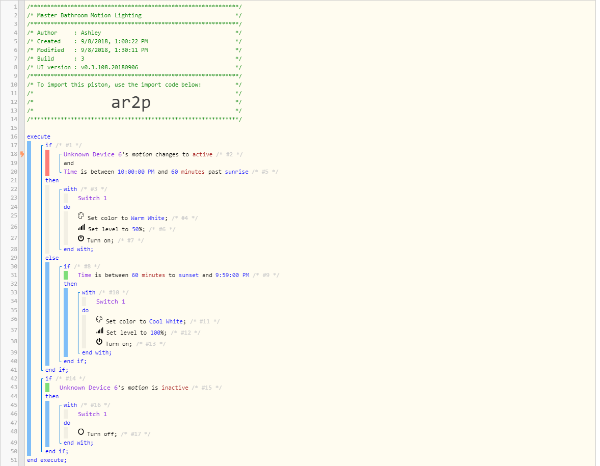

Motion sensor will see motion initially but it does not keep continuous motion active.
Lights should turn off once motion has stopped not 60 seconds after initial trigger
The motion detector is getting triggered on initial motion detection but then will turn off 60 seconds after even though there is still motion. It will then be off for a few seconds and turn back on again for another 60 seconds. I am not sure if this is something with the motion detector (Xiaomi motion sensor) or with my piston?
**4)
**5)

+0ms ╔Received event [Master Bathroom Motion Sensor].motion = inactive with a delay of 100ms
+109ms ║RunTime Analysis CS > 58ms > PS > 30ms > PE > 21ms > CE
+124ms ║Runtime (48180 bytes) successfully initialized in 30ms (v0.3.107.20180806) (123ms)
+129ms ║║Comparison (enum) inactive changes_to (string) active = false (0ms)
+130ms ║║Cancelling condition #2’s schedules…
+130ms ║║Condition #2 evaluated false (3ms)
+131ms ║║Condition group #1 evaluated false (state did not change) (4ms)
+159ms ║║Comparison (time) 65144223 is_between (time) 1536487500000 … (time) 79140000 = true (2ms)
+159ms ║║Time restriction check passed
+160ms ║║Condition #9 evaluated true (28ms)
+161ms ║║Condition group #8 evaluated true (state did not change) (28ms)
+162ms ║║Cancelling statement #10’s schedules…
+6630ms ║║Executed physical command [Bathroom Light].setColor([[hex: #F3F6F7, hue:52, saturation:19, level:96]]) (6458ms)
+6631ms ║║Executed [Bathroom Light].setColor (6464ms)
+9916ms ║║Executed physical command [Bathroom Light].setLevel([100]) (3279ms)
+9917ms ║║Executed [Bathroom Light].setLevel (3280ms)
+9931ms ║║Skipped execution of physical command [Bathroom Light].on([]) because it would make no change to the device. (5ms)
+9932ms ║║Executed [Bathroom Light].on (8ms)
+9938ms ║║Comparison (enum) inactive is (string) inactive = true (1ms)
+9939ms ║║Cancelling condition #15’s schedules…
+9940ms ║║Condition #15 evaluated true (6ms)
+9941ms ║║Cancelling condition #14’s schedules…
+9942ms ║║Condition group #14 evaluated true (state changed) (8ms)
+9944ms ║║Cancelling statement #16’s schedules…
+12465ms ║║Executed physical command [Bathroom Light].off() (2513ms)
+12466ms ║║Executed [Bathroom Light].off (2515ms)
+12469ms ║╚Execution stage complete. (12343ms)
+12501ms ╚Event processed successfully (12501ms)
