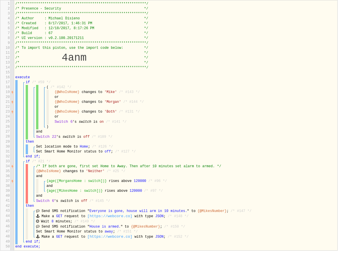

My piston below hits the variable “value:Neither” and from there ends the trace. I would like this piston to actually wait once it turns to Neither to see if the occupants are indeed gone for the allotted 2 minutes.
How to make presence piston wait for occupants to be gone long enough

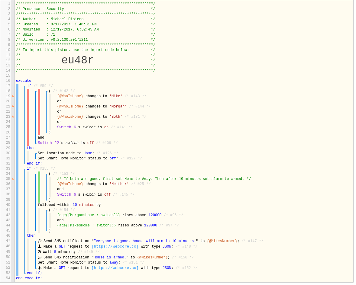

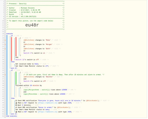

So I gave followed by a shot (see below) and it waits, but now it waits too long. I’ve shortened the time and have had failures. I’m trying to figure out if the issue is within rises above or if its within the wait time.
eibyer
My suggestion is just to remove the age() stuff and do a simple wait 2 minutes. The timer will cancel if @WhoIsHome changes away from Neither?
mdisieno
Gotcha. The main reason I had that was to forgo if the wifi ever cut out or something like that. Cox communications isnt the most sturdy of internet
