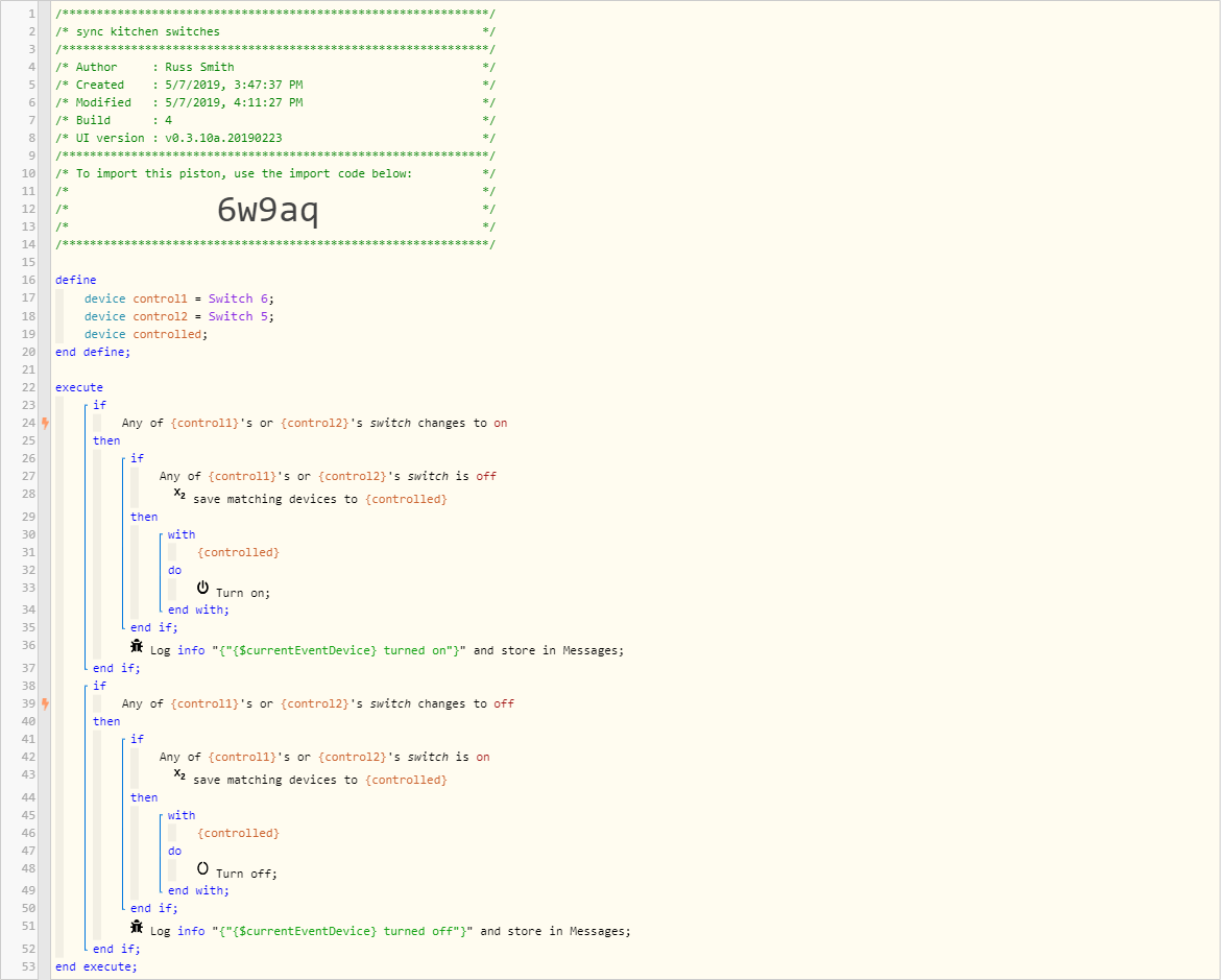

I have two “synched” switches (either switch turning on turns the other on. either switch turning off turns the other off) and the piston works flawlessly about 99% of the time. The exceptions always involve flipping a switch and then flipping it again right away.
I expect that whenever I flip one switch, the other will be set to the same setting (on or off). I would tolerate ignoring a second flip within a certain amount of time after a first flip.
Most times, it works as it should. The only times it doesn’t is when two flips occur within seconds of each other. In some cases the light physically attached to the switch turns off and then flips back on again.

There is another method you should check out —> Smart Lights mirroring behavior.If your lights are local then the smart lights rules would run locally. You simply need to create two rules (one for each light to mirror the other). :slight_smile:
Agree with @jkp. It’s probably a network latency issue when the switch is cycled quickly.
Figured as much. I was wondering if I should just put a time delay in. However, I’ll check out Smart Lights, which I already have installed :slight_smile:
Good news: Smart Lighting not only works (exactly as jkp said, with two rules), but also has a lot less latency time. I’m not sure exactly why that’s the case as Smart Lighting and WebCoRE are both running as Automations and so, conceivably, both are receiving the controlling switch’s state and then acting on the controlled switch’s state. Nonetheless, Smart Lighting is a fraction of a second latency and the Piston I wrote was about a full second. That almost certainly is why the quick cycle “confused” the Piston.
Thanks for the help, both of you. Both sets of switches now work precisely as they should.
