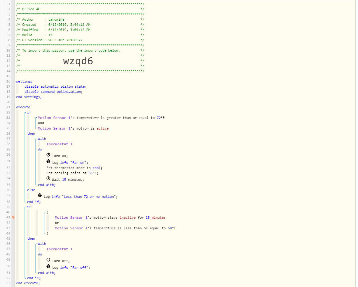

How to run my AC for at least 15 minutes, but check the conditions more frequently
I’d like my piston to run for at least 15 minutes, but not at 15 minute increments.
If the temp is above 72 and there is motion for the AC for at least 15 minutes, then if motion stops or the temp is below 68 turn off the AC but ONLY if it has been 15 minutes.
It appears to be waiting for 15 minutes each time it executes.

I blieve the problem is,
you have 2 conditions and priston is firing multiple times.
Meaning,
your temp just turned 72 (Conditions is TRUE)
Your motions is active (Condition is TRUE)
Piston executed
Wait coundown started…
but as long as conditions are still TRUE in your enviroment, the piston needs to execute AGAIN.
Maybe something like this would help…
Lets say you want to keep the room around 70.
IF Temp rises to or above 70 (TRIGGER)
and
IF The motion sensor is active (CONDITION)
THEN
DO TURN ON the AC
IF TEMP Drops below to or 69 (Trigger)
OR
IF the motion sensor is INACTIVE (CONDITION)
THEN
Turn OFF AC

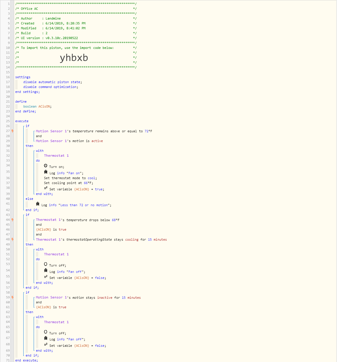

Try this:
The execution is divided into three Ifs, each with a trigger to make them execute when the most likely condition changes. I added the ACisON variable so that the off triggers and conditions only proceed if the AC was turned on by this piston. (Dueling pistons are no fun.)
I suppose one could combine all the off conditions together as:
If ACisON is true and
    Motion 1 stays inactive for 15 minutes
  or
    Thermostat drops below  68F
     and
     ThermostatOperatingState stays cooling for 15 minutes
Then...
But I find that the more convoluted the logic gets, the harder it is to follow when you’re trying to figure out what you did a year from now. It would only make sense to do if the With Thermostat Do code was significantly longer.
Thank you your reply, it helped me understand webcore better.
This seems to be working perfectly, thank you!
I’m shocked how well importing worked!
