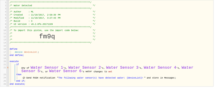

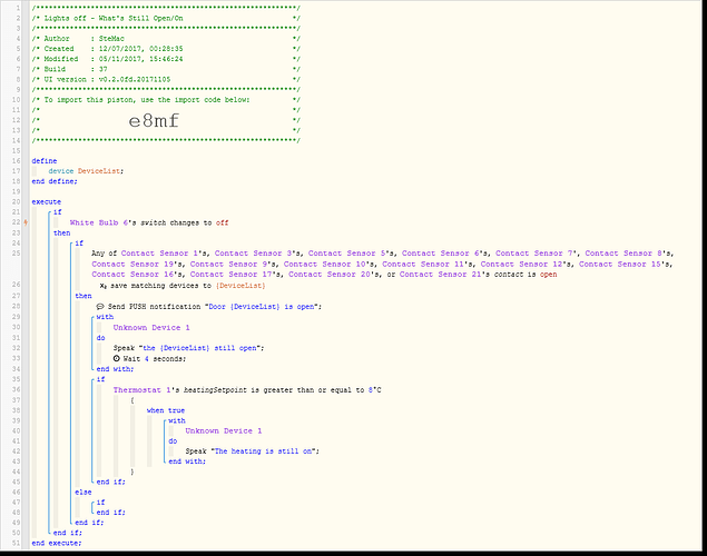

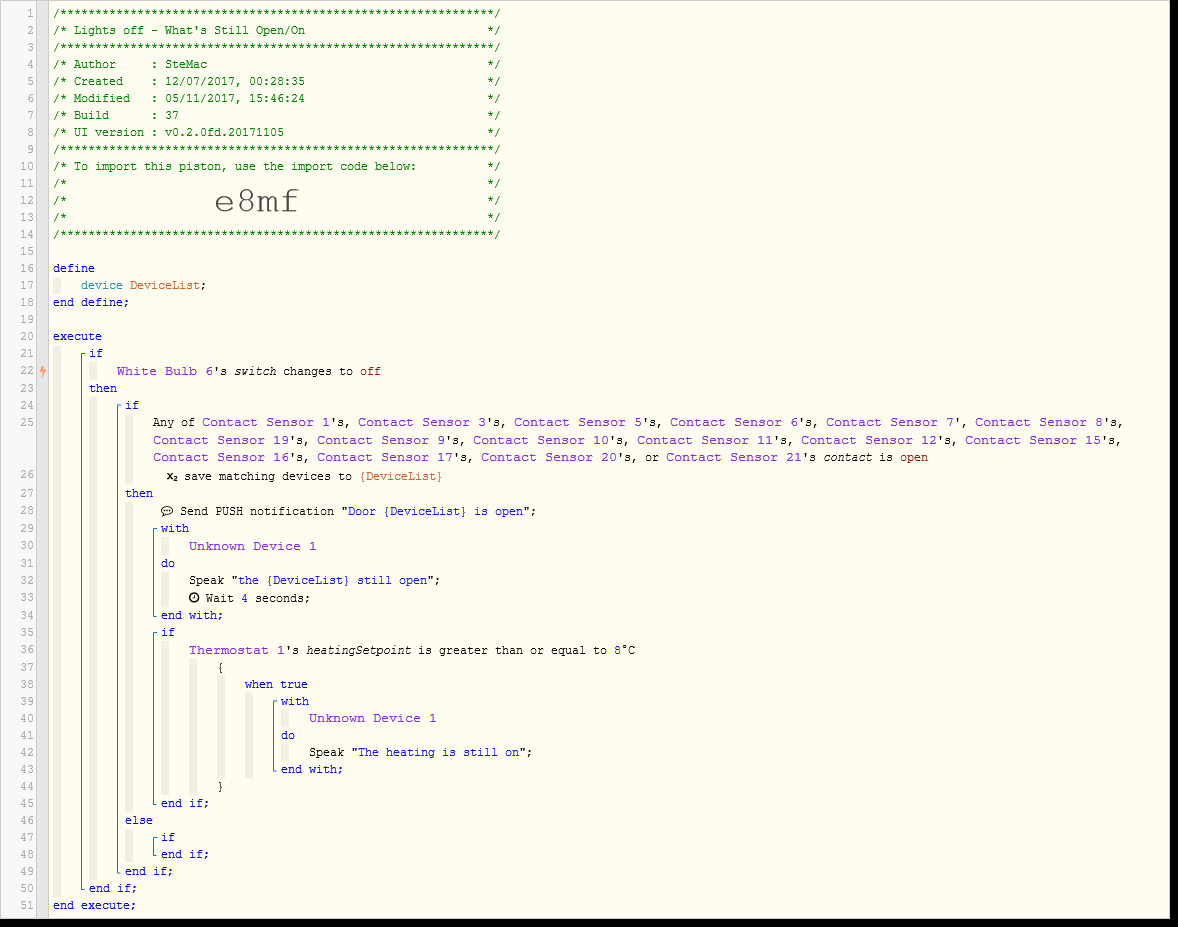

I’m obviously missing the obvious here but in an example piston, the statement “save matching devices” to a variable is used. I can’t figure out how to use the IDE to create that statement. Here’s the piston with the statement to which I’m referring:
I want to send a push notification if any water sensor in my house detects moisture and I want to include the specific sensor or sensors that are wet. I can’t figure out how to capture the sensors that are reporting water.

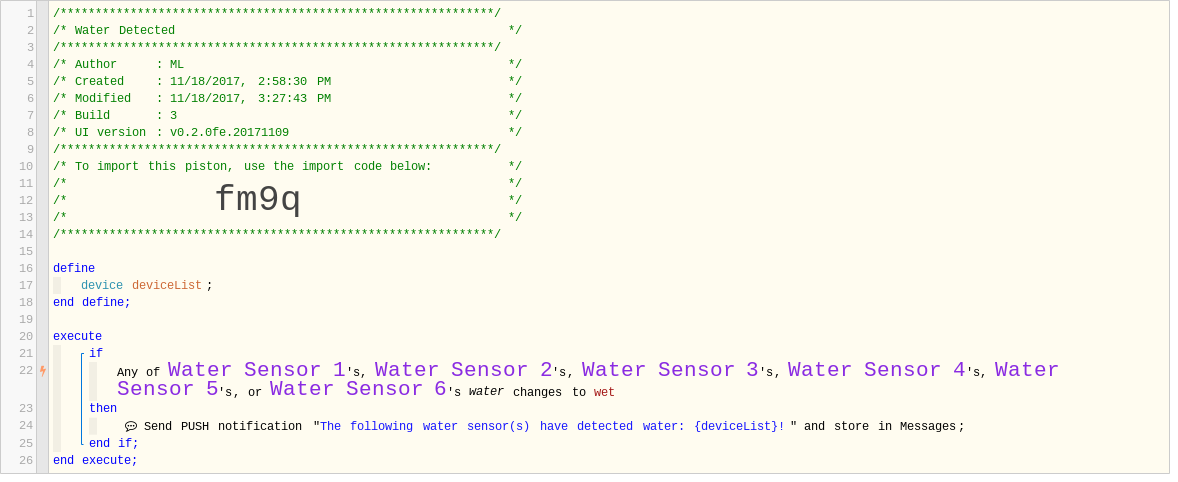

Here’s what I have so far. I just need to figure out how to write the statement that will populate {deviceList} with the sensor(s) that detected water so I can include that in the push notification.
