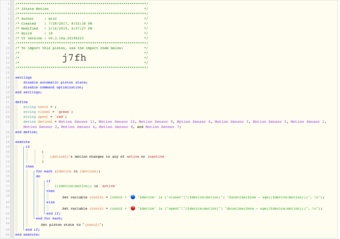

Try this. I do the same thing with this piston.

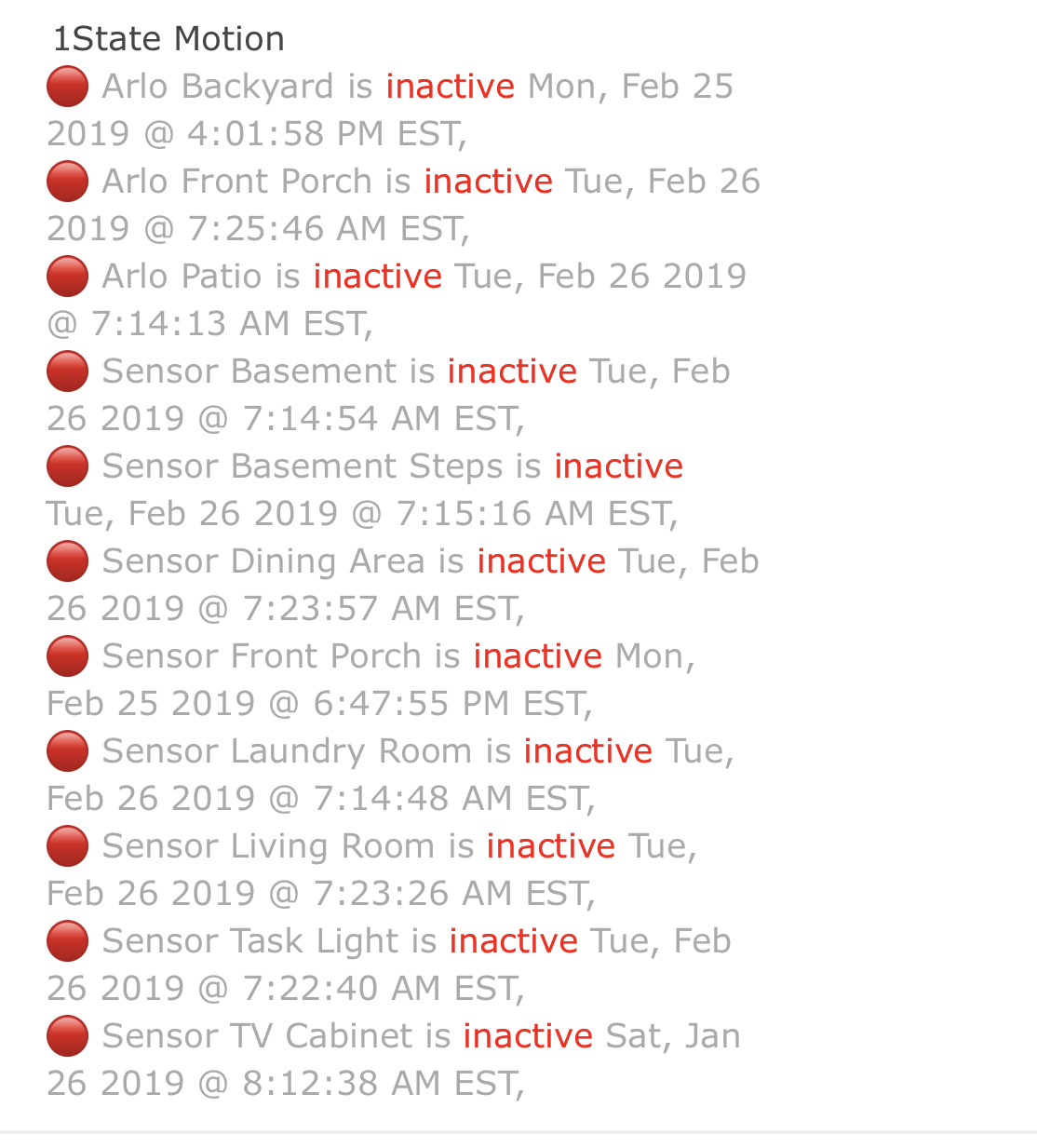

This piston will give you this.
age([device : attribute] was exactly what I was looking for.
