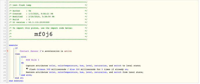

Hue bulb not restoring original values in piston
Testing a simple piston with a Hue bulb. It looks like the bulb state is not being captured, or the “revert” does not happen…
when the trigger happens, flash the light (change color/intensity), then revert to what the original captured state was.
light flashes, then goes to full blue (first value in fash sequence), instead of returning to white (or off if that was the original state)

you may want to post an image of your piston

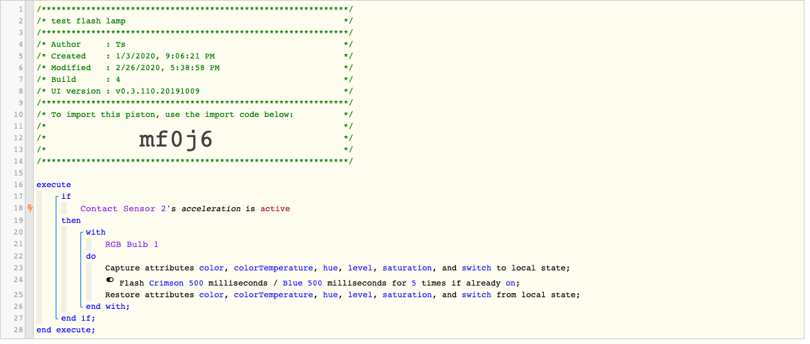

Sorry, new to the forum… thought I would just paste the code… here it is:
Also tried this with Hue non-color bulbs, they flash, then turn off (last state in the flash sequence)…
I’ve not worked with colour bulbs but am aware they can be a bit quirky about colours and levels.
The logs show that the value for ‘color’ being restored is null / empty. I don’t know if that is confusing the issue.
The piston is also skipping the level and switch settings as they are believed to already be correct. Again I don’t know if that is an issue. That is called ‘command optimization’ and can be turned off in the piston settings.
