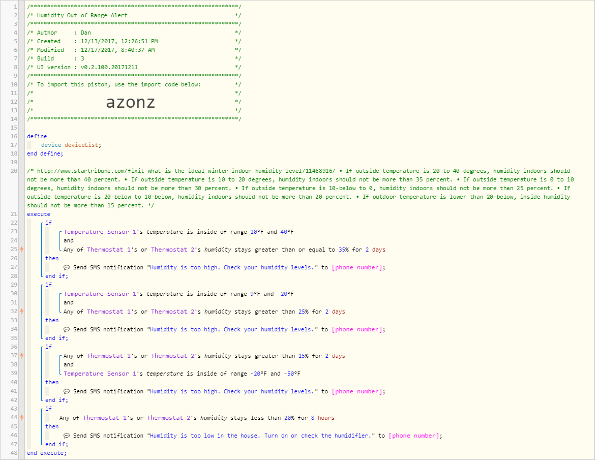

I have a Nest integration setup and can measure humidity, but my problem is that the temperature outside can change a lot, so I have a piston check to see if the humidity goes too high and generally too low. I’m not sure how to approach this piston. I just built it out today, so I’m not even confident that the “for 2 days” would even work - as the temperature outside could make it “reset”?
Here’s my first shot at building this out.
Anyone have any suggestions / ideas to make this just generally “work better”? Any ideas or suggestions are very much appreciated!
As an fyi, this automation is built into nst manager
You could streamline a tiny bit using a switch case but it won’t achieve a great deal… if it works I’d leave it alone.
