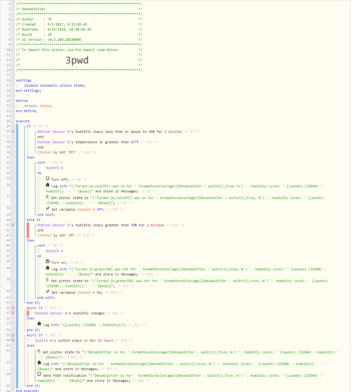

Without any known devices to start with, it should be as simple as this:
IF
Humidity Sensor is greater than X%
With ST Outlet, Turn On
Else
With ST Outlet, Turn Off
If my humidier stays on for a long time (esp in a low temp) it will start to ice up. It’s older. So hence me wanting to know when it’s been on for over 12 hours…
This could clearly be cleaned up with some variables since I’m using direct names in the log entries…but…it should get you going.
